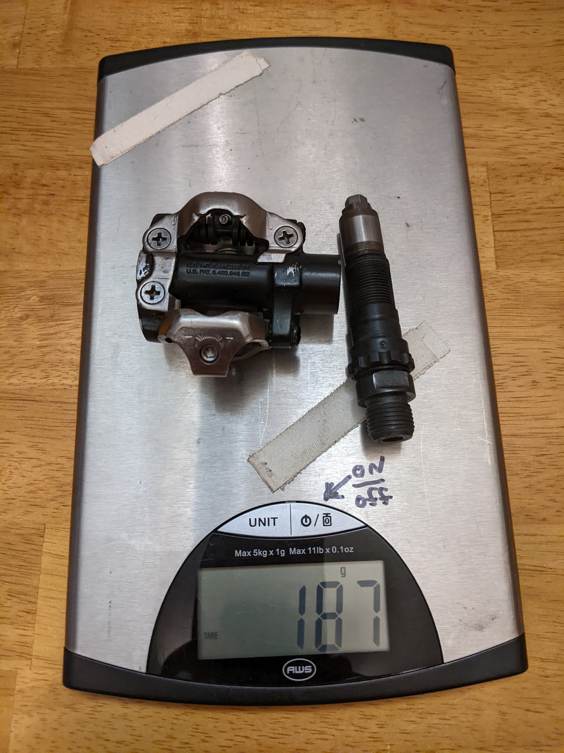

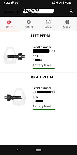

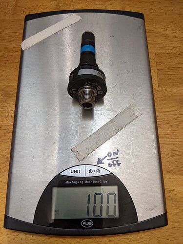

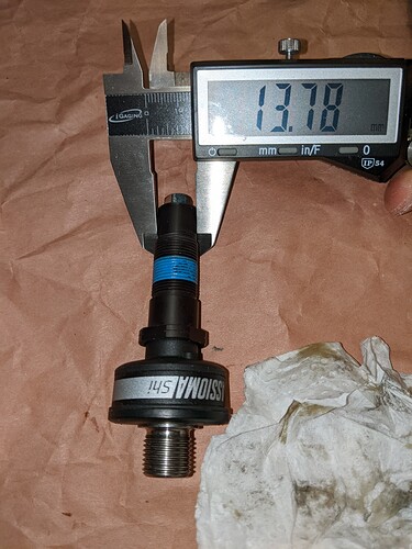

follow all+any directions:
  1. screw out old,
  2. screw in new Duo-Shi,
  3. install pedals with washer on cranks:
  4. test on TACX trainer and match power.
    looks all good yay.
    Uploading: PXL_20220919_220807661.jpg…
once i’m comfy with units might check out more diff types of shimano pedals bodies to test out
