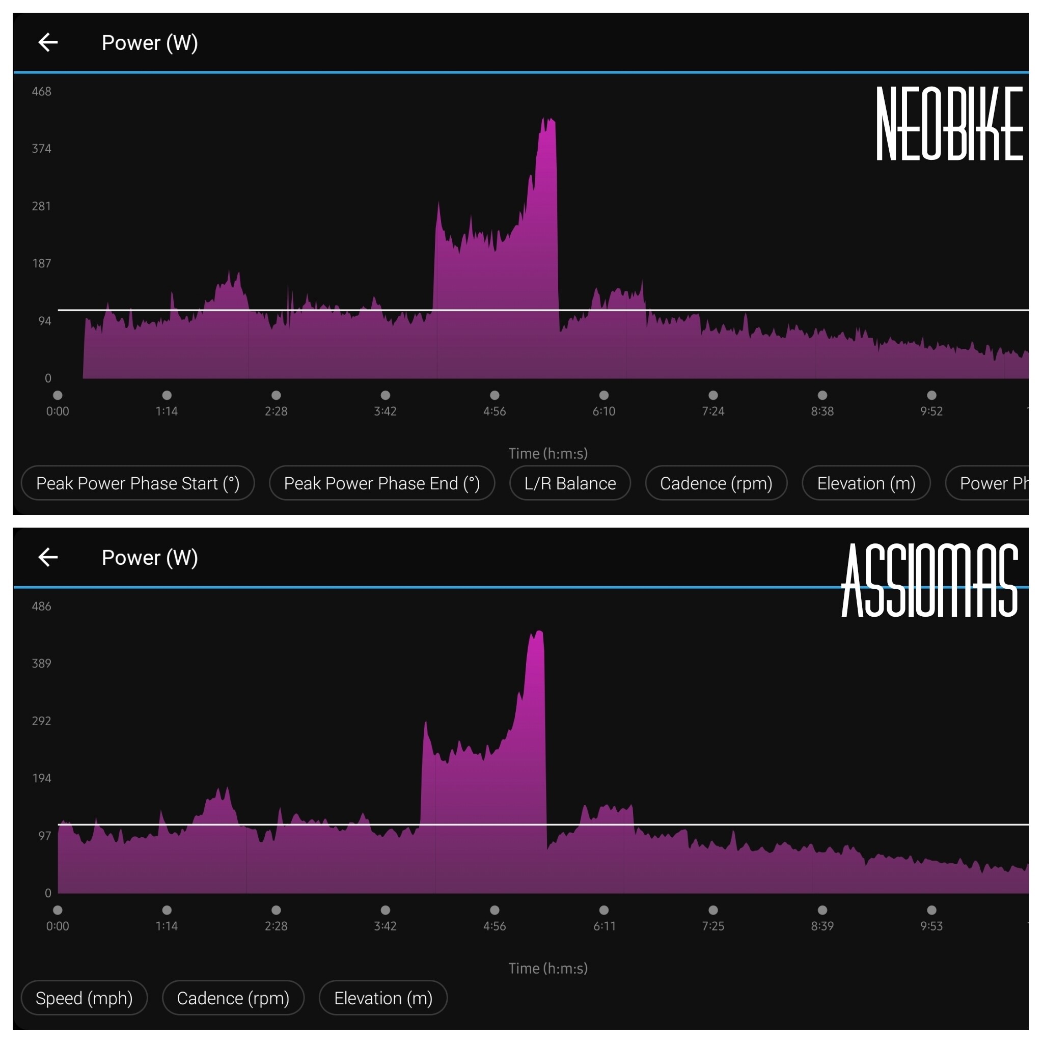

So I decided to start with the cheapest option first, and ordered some Bontrager MTB Comp SPD’s.
Arrived this morning, so got them swapped over.
Popped them in the NeoBike for a quick test, and all seems to track OK. Sadly I had just finished the morning run, so legs were too shot to do any consistent power efforts. But from the quick effort I did, they seem pretty darn spot on.
When put together they feel fine, no play on the axles, all buttoned up nicely and no movement, and they still spin freely.

For mine, no bearings were carried over, just just what is in the Bontrager pedals, packed with a bit of extra grease. End bolt from either pedal fits fine, and the end cap is from the Bontragers too.
Not used them outside yet, planning to soon, but did a trainer session for an hour just now, very stable, track perfectly with the trainer as far as power changes go. Around 8-10 watts in it for the hour average. So not spot on, but nothing to lose sleep over. That said, I haven’t zeroed them since switching them to the trainer.
Will do that for the next test ride.
