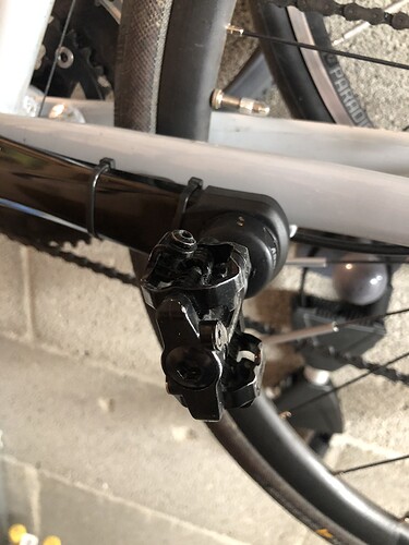

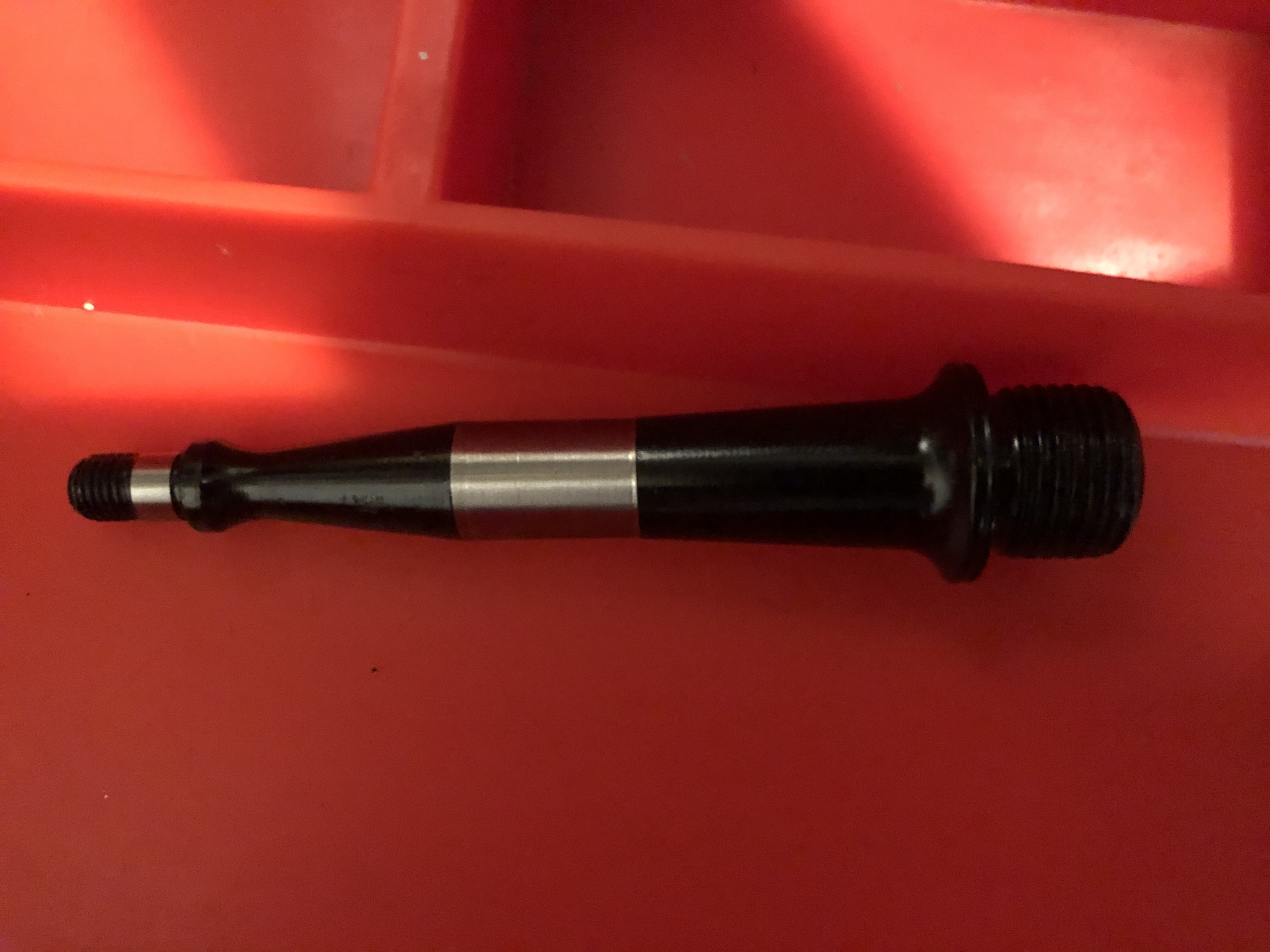

I‘ve tried the hack with the Bontrager SPD Pedals. Although they pedal-body of the Bontrager only got 2 bearings (1 inner and 1 outer) and the axis is slightly different to the Assioma axis (see the Photos) the hack seems to work and the Bontrager pedal-body spins on the Assioma axis as easy as on the Bontrager axis. The power data is more or less the same compared to my Wahoo Kickr Core (average Power is exactly the same).
I used the Assioma Axis + Bontrager pedal-body + Assioma Nut + Bontrager Endcap (but also worked with the one from the Assioma). I couldn’t use the Assioma inside washer/O-Ring because otherwise the body would have been too tight to spin freely. However there is a rubber-sealing „included“ in the Bontrager pedal-body so I think it is alright. No wobbling/play of the pedal-body at all. I also didn’t had to use loctite etc.
I also added a crank-arm bumper (Zefal Crank Armor XL Kurbelschützer - bike-components) so that the Assioma battery-body is not standing over the crank arm.
