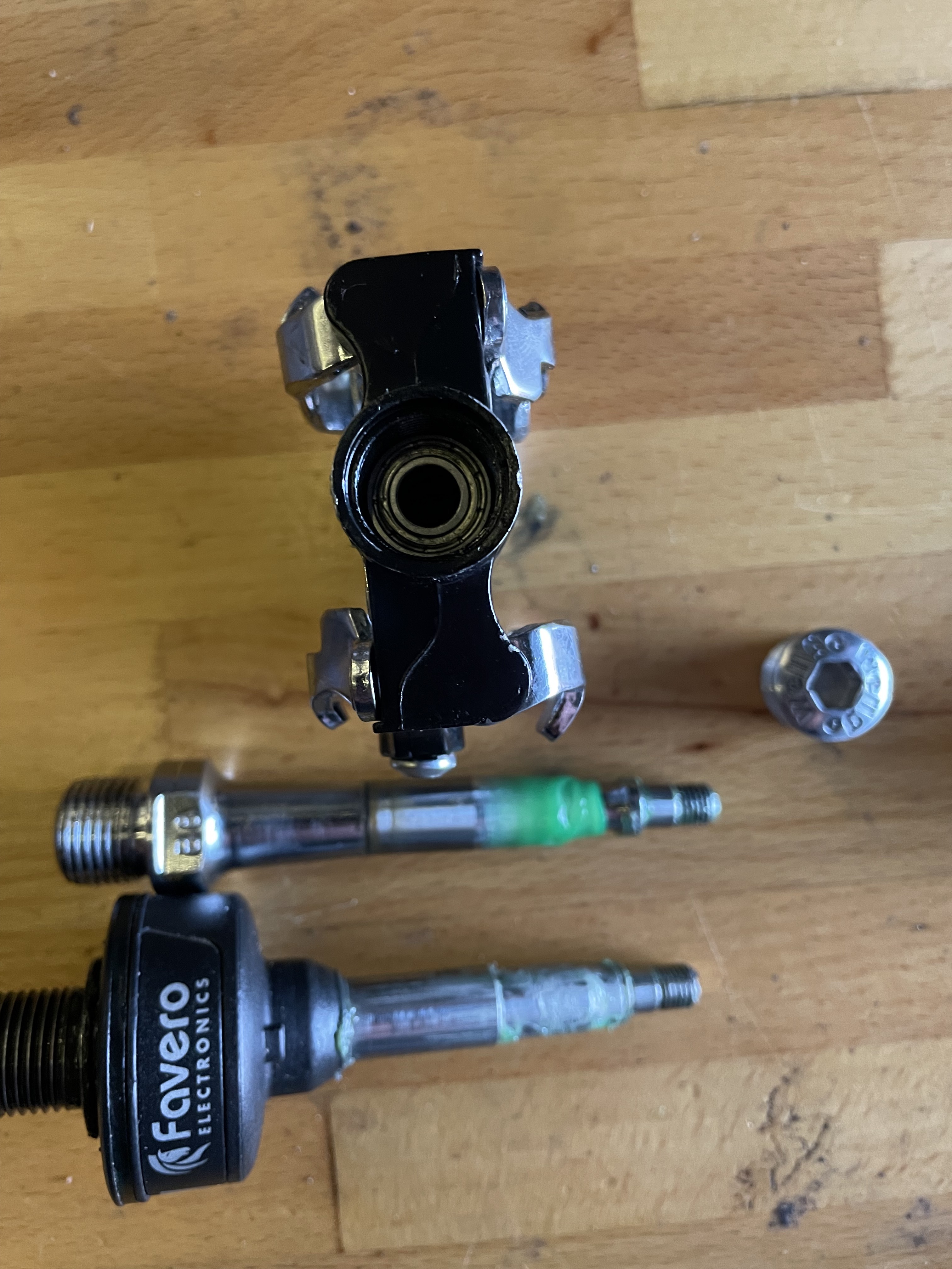

A Wild idea for Favero Assioma pedals [MTB SPD Hack]

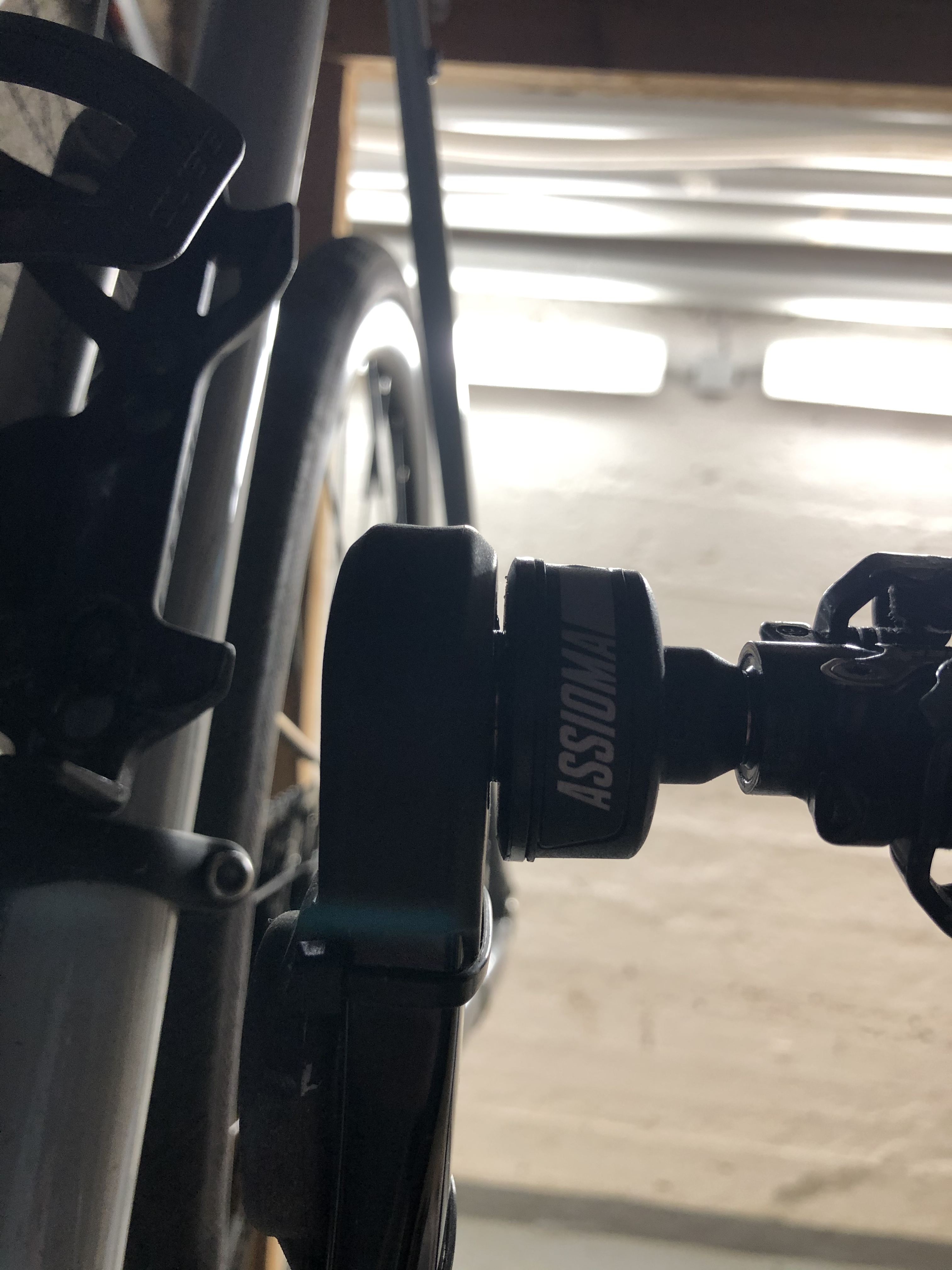

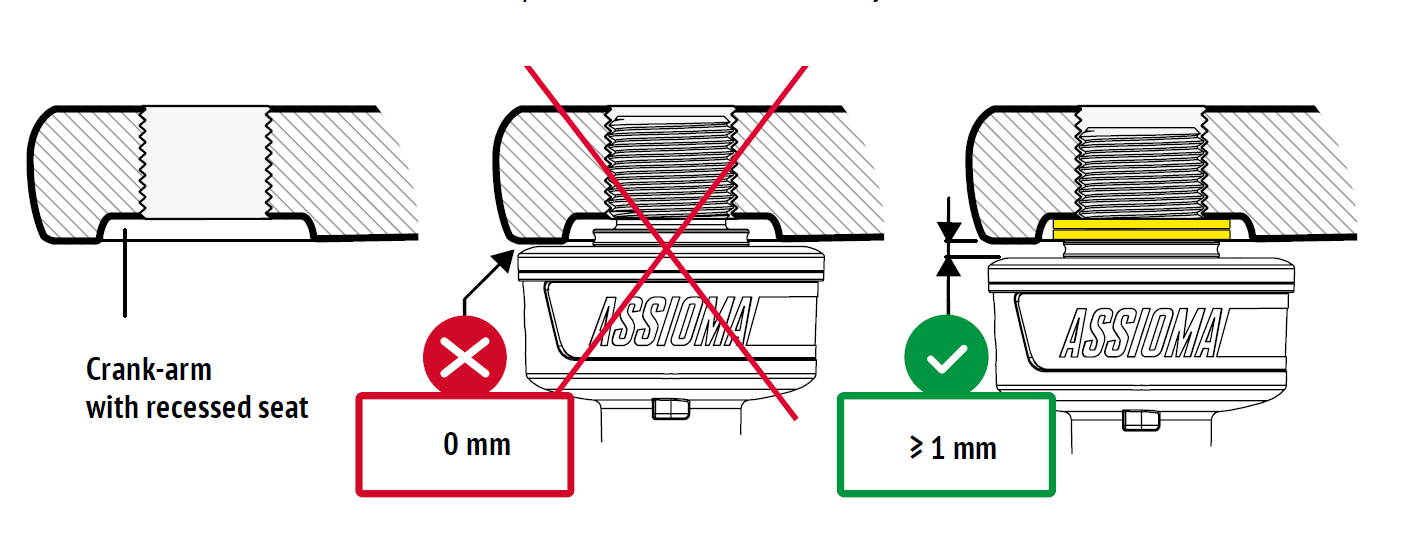

It might be the picture, but I can’t tell if you have a gap between the sensor and the crank arm. I think the user manual requires a gap.
Ha. No. I also have to hit the magnifying glass every time.
I hate that depending on what device you use on the forums you can’t tell which comment people reply to.
Gods point, have to check this later, but it’s the crank-arm-bumper (Zefal Crank Armor XL Kurbelschützer - bike-components).
Anyhow, any idea why that should be or if there is any problem with my setup with no gap (the bumper itself is quite soft rubber)?

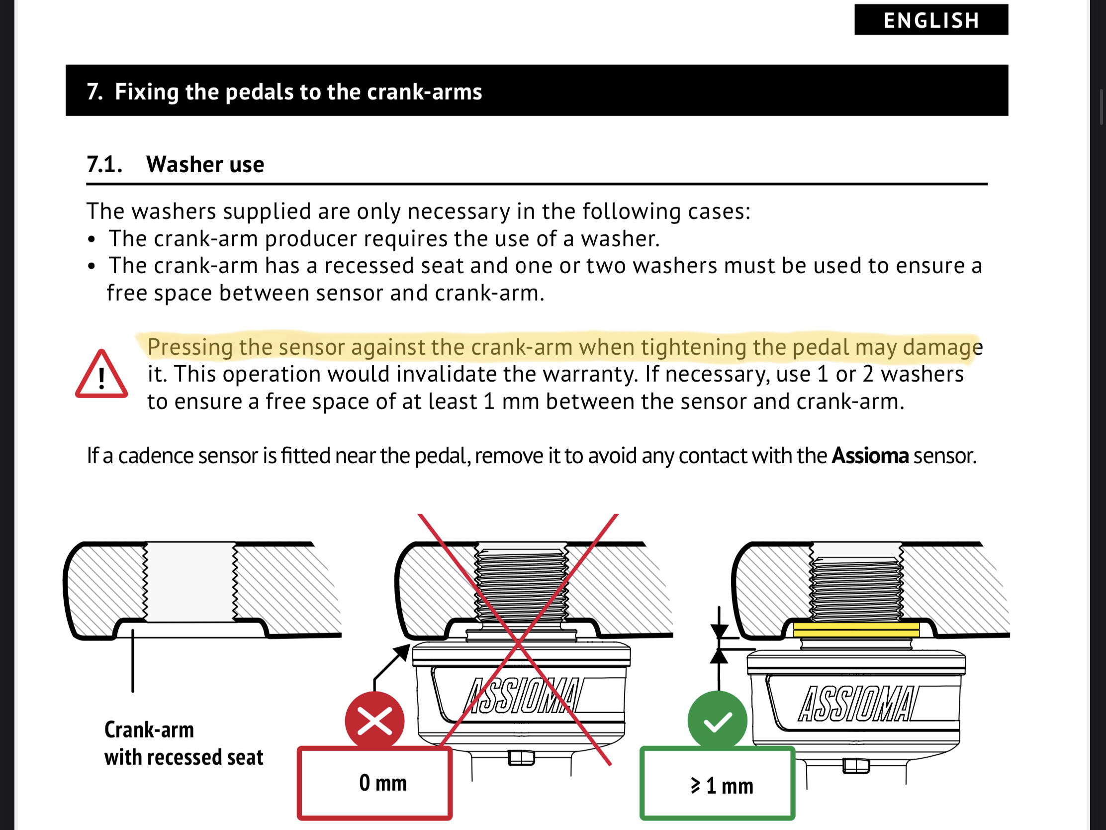

„Pressing the sensor against the crank-arm when tightening the pedal may damage it“
So I guess it will be Fine, because the pumper is softer than the crank arm
I have thought about including a bumper or crank arm protector too.
I think the main reason for a gap between the sensor and the crank arm is that the pedal itself will continue to torque down (tighten) itself against the crank arm as you pedal. This is because your weight/power will continue to rotate the pedal around its axis.
As you say, the bumper is quite soft and will likely deform. That said, soft things become hard once all the elastic deformation capability is gone. Think of squeezing an eraser…sooner or later it is hard.
In reality, I think the bumper will likely break before the plastic cover of the sensor. Perhaps just ride a few rides and take off the pedals and check for wear on the plastic and bumper.

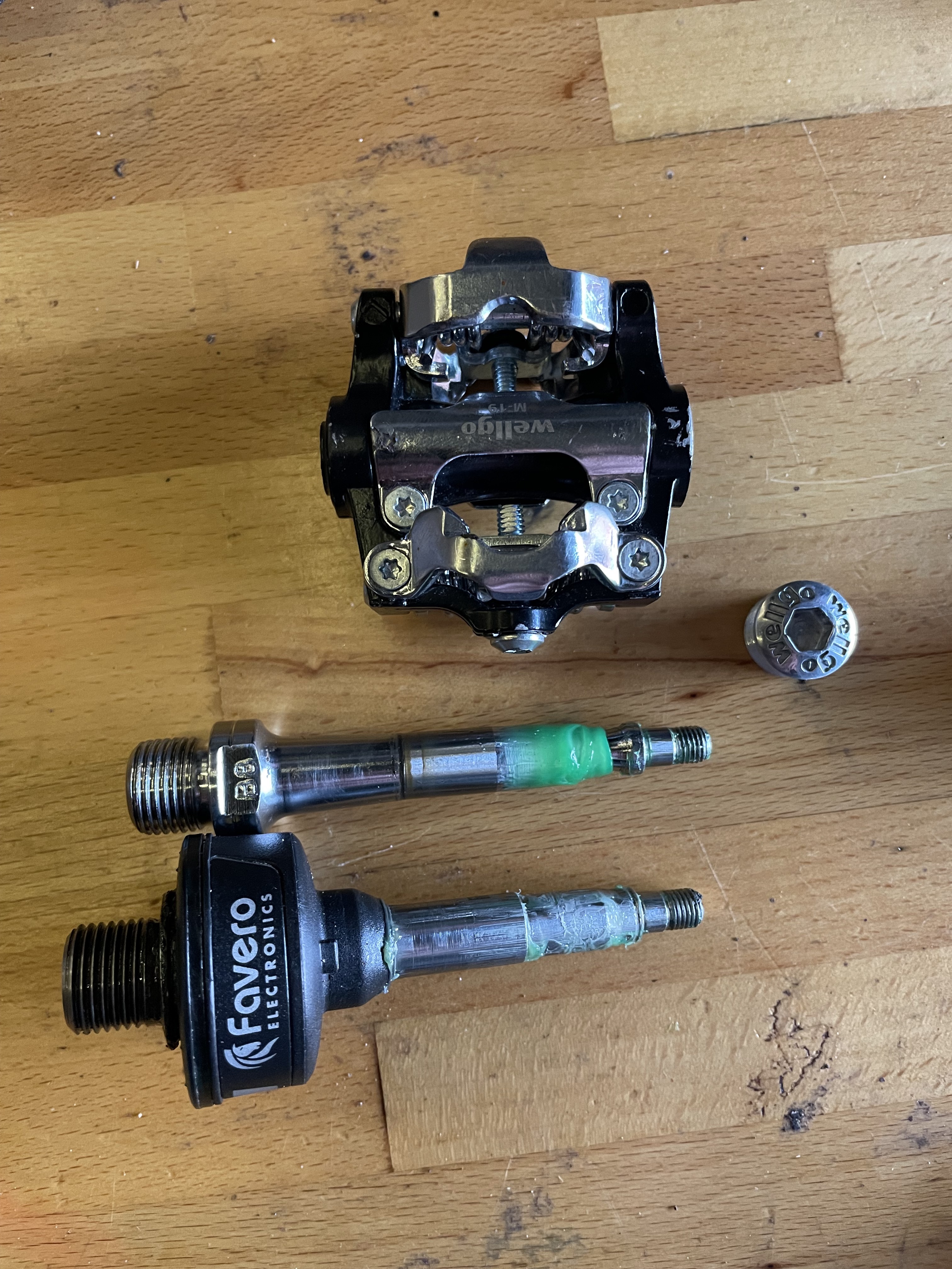

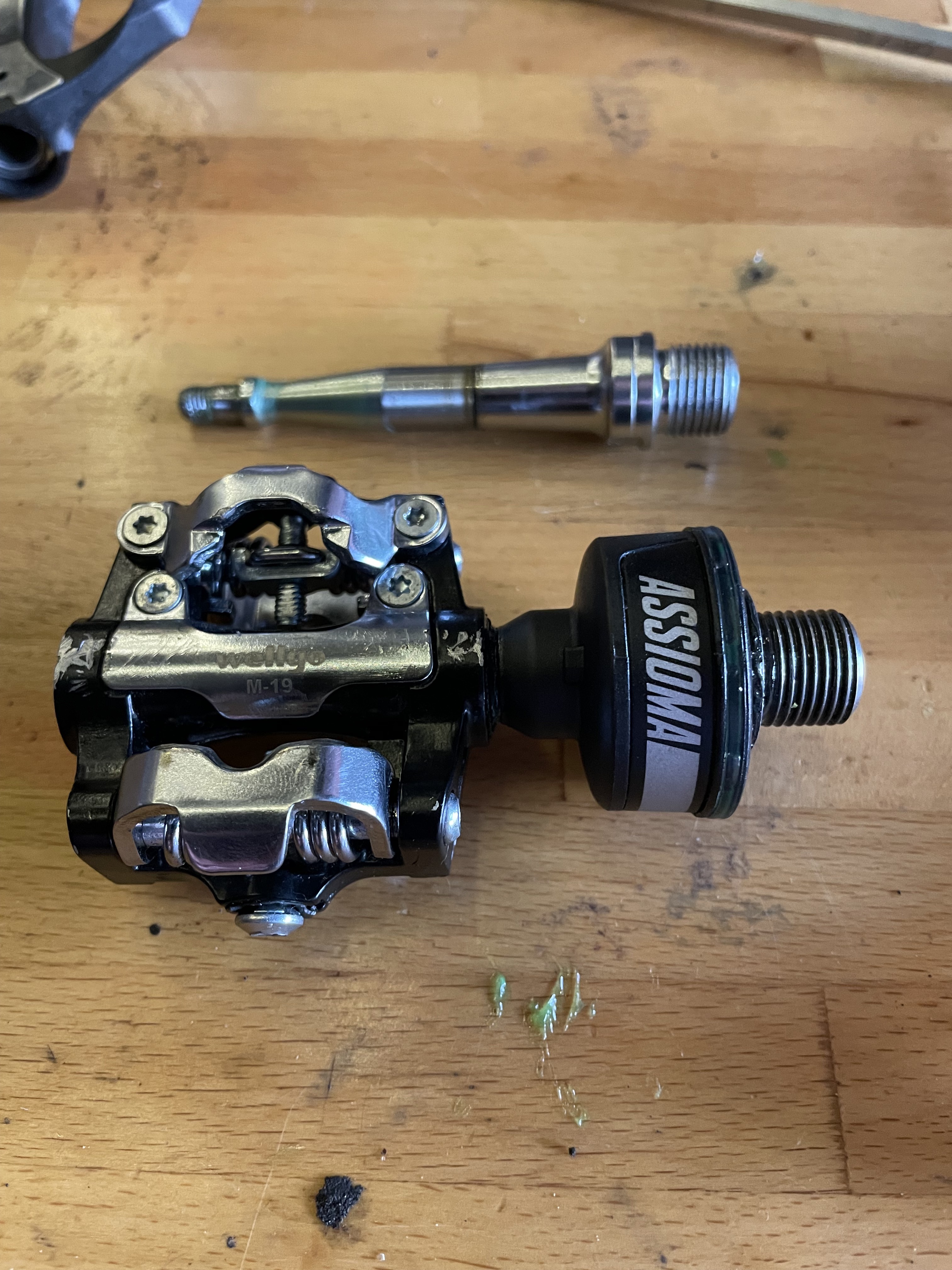

The Wellgo M19 pedal works with the Assioma hack.

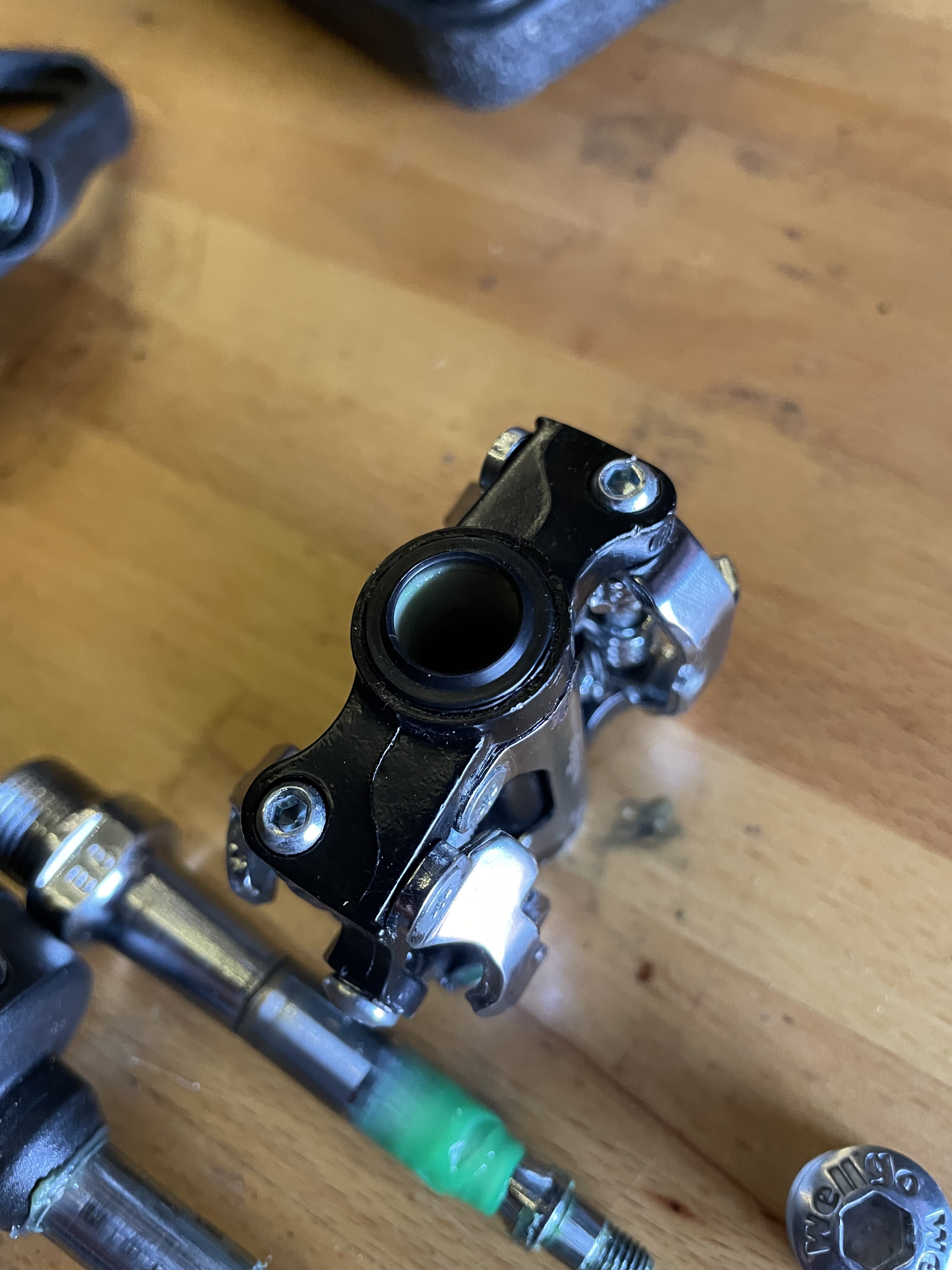

This pedal is a very cheap, both in price and construction. Lots of pressed medal parts.
Pedal body has inside DU bushing rather than bearings (plastic surfaces) and the same outer bearing as the Assioma. I used all the parts from the Wellgo pedal and it spins with no binding.
I’ve not tested the feel yet but as I said - cheap!

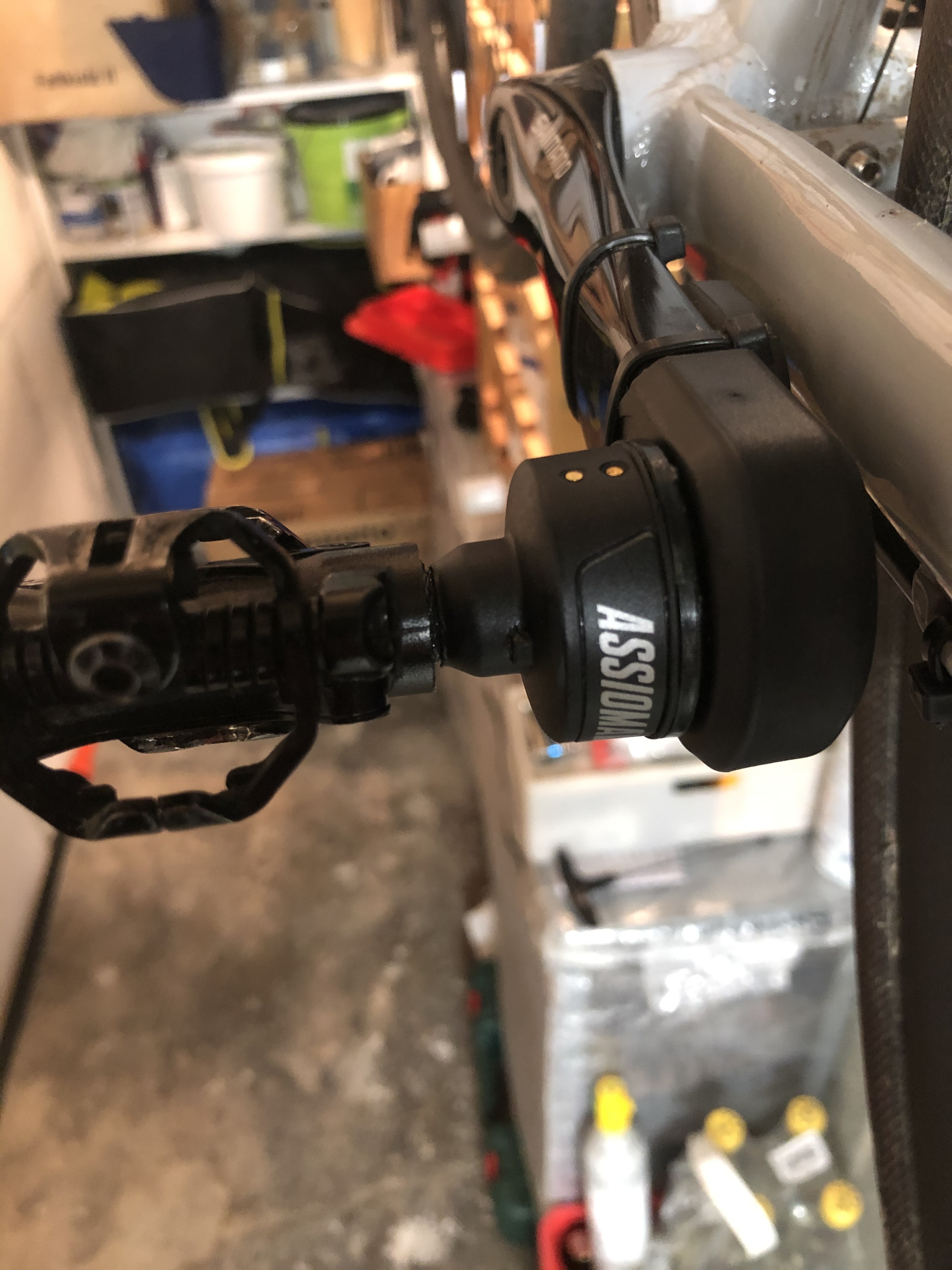

Just added the second washer and now I should be fine…thanks for your advice :slight_smile:

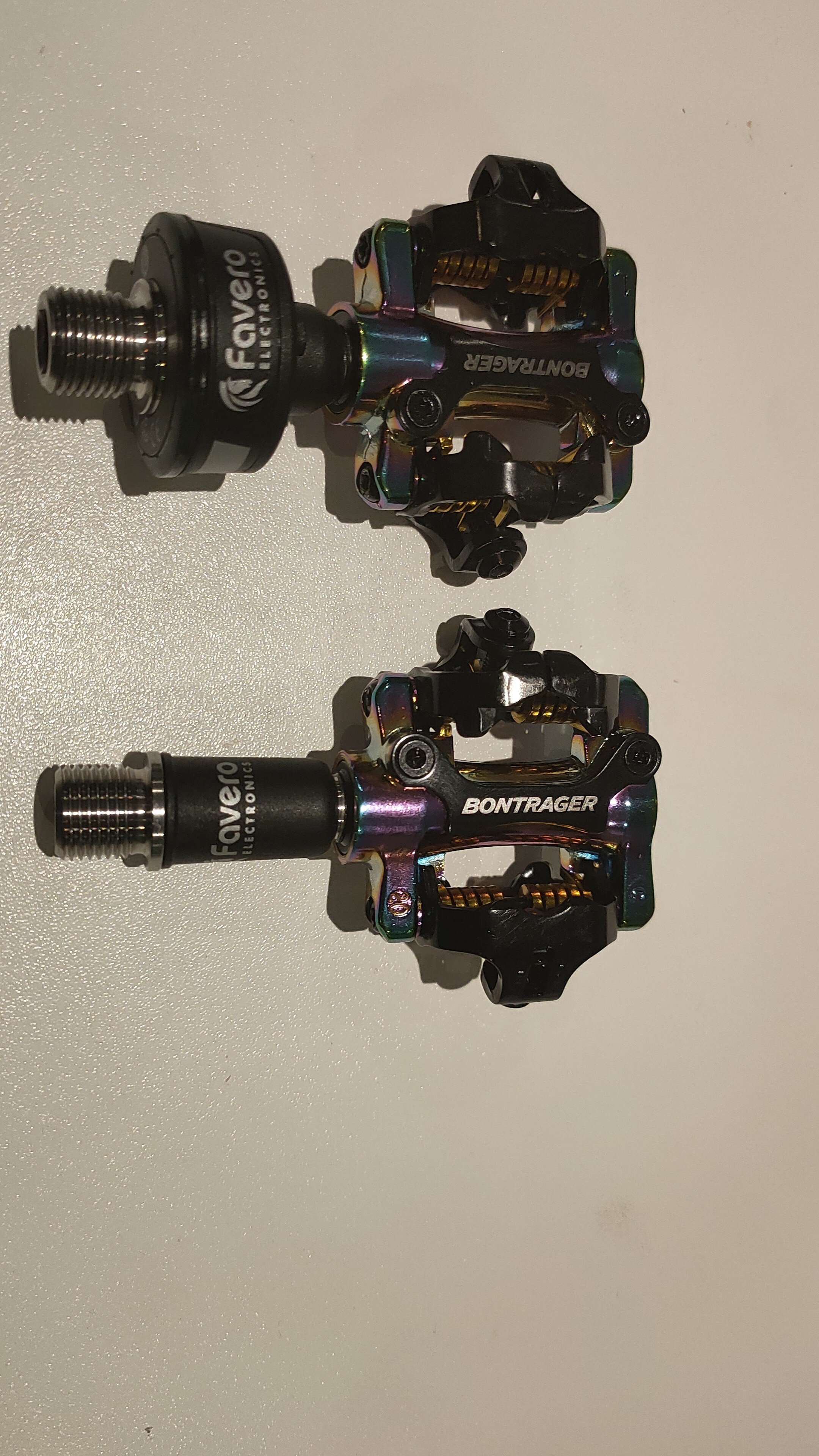

The axis as well as the inside of the pedal-body looks very similar to the one from Bontrager.
I’ve just added the second washer. So there should be enough space/protection.
Just to share: works flawlessly with Bontrager Comp SPD pedals (combined with Shimano RX800 shoes: no need to cut anything) :ok_hand:t2:

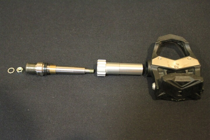

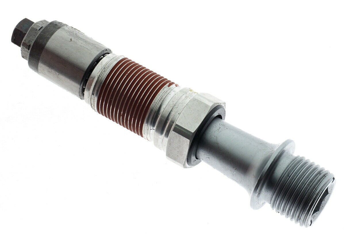

Has anyone tried this with any shimano pedals like the PD-ES600? Saw the post about shimano PD spindle image but that is not confirmed
Not happening. CyclingTips has promising news for you though.

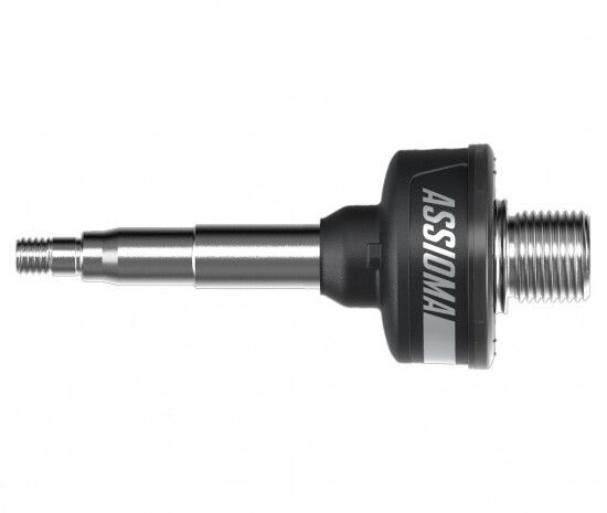

Favero spindle
ES600
next layer
Garmin’s solution
Shimano’s body is build around loose balls, the others are cartridge/needle
ISSI 3 works like a charm! Exact same spindle and bearings as the Assioma. And I was able to fully tighten the internal nut with no Threadlock needed.

Bontrager Comp - I think these are a straight and easy swap
Wellgo M19 - I think these are a straight and easy swap
ISSI Flash 3 - straight easy swap but I’m in the UK so options are limited
Can anyone confirm that the Bontrager and Wellgo pedals can be torqued up without binding and are indeed straight forward and easy to swap over?
Wellgo M19 is 5 minute swap no binding fully torqued
Perfect thanks. Just ordered a pair cheapest I could find was £34 though!
For the CXR/Baldwin, you do not need to use loctite. I recommend against it for multiple reasons - mainly safety.
Best method for these Xpedo pedals is to remove the inside oil retainer / washer. This leaves the inside more susceptible to dirt/water ingress, but the bearings use rubber seals, which should provide some resistance. More importantly, the nut can be properly torqued to ensure the it doesn’t back off.
This is what I did with my CXRs, no trouble so far. Should probably give them a good clean soon though.
