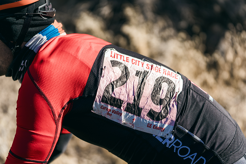

Note: When pinning your number to your side, use the fabric seam closest to the chest to align the bottom edge of the number. This keeps the number visible.
Properly placed race number

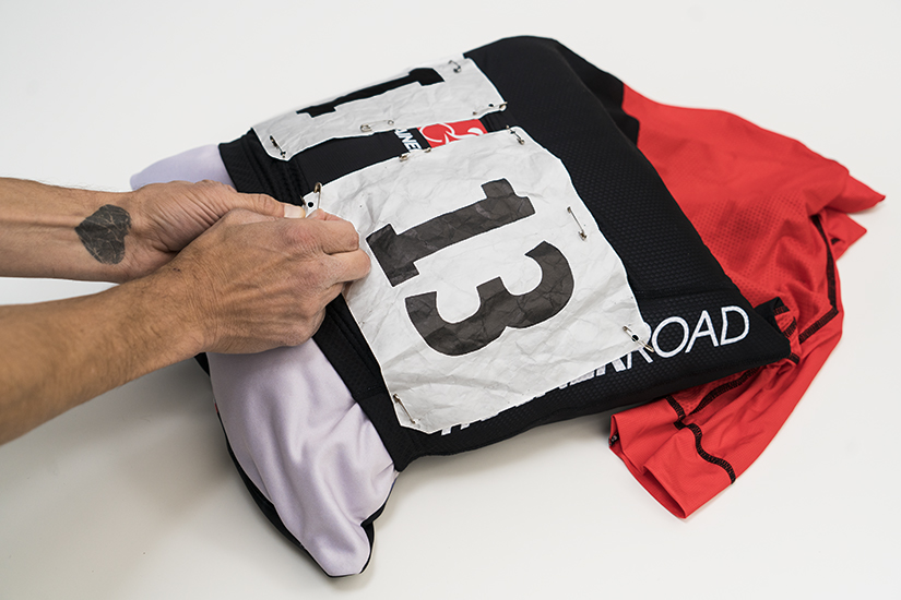

The pillow technique is our go-to choice to pin your race number solo. Wrapping your jersey around your pillow mimics the shape of your body, allowing you to pin the number just like it would be pinned if you were wearing the jersey.
Number pinning using pillow
