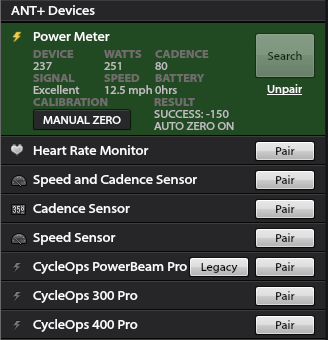

- Collapsed Device Page
- Manual Zero ANT+ Power Meters

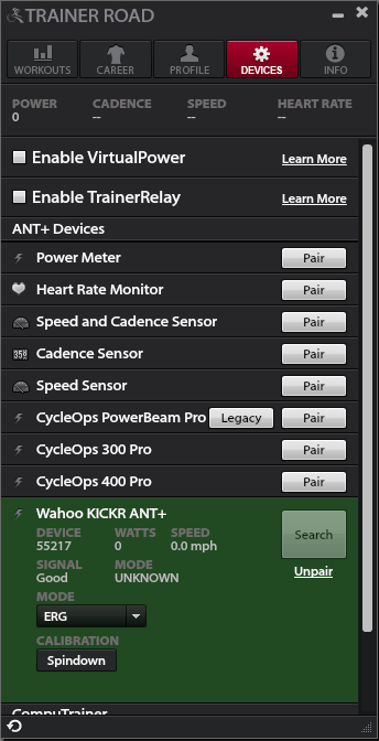

We’ve collapsed devices when they aren’t paired. This makes it easier to see what’s available and what you have paired.
We’ve added the ability to manually zero ANT+ power meters that support it. When you click the “manual zero” button pictured below, we’ll send a “zero” request to the power meter. If your power meter supports it you’ll get back a success or fail message. Make sure you’re off the bike when you manually zero your power meter.
So, what does zeroing do?
You can think of zeroing your power meter like hitting “tare” on a normal kitchen scale. Your power meter is full of super sensitive strain gauges. We want to tell your power meter that it currently doesn’t have any load on it, and that it should use this as it’s “zero” point when measuring load.
When do I want to do it?
How often you calibrate your power meter depends on your power meter. But, a good rule is to do it once before each ride. You’ll especially want to do it if you have a big temperature swing as this affects most power meter readings.

We’ve added and improved roll down support for the Kinetic inRide, Wahoo Kickr and CycleOps Power Beam Pro. Here’s how it works. We’ve added a spin down button when the devices are paired.
Spindown

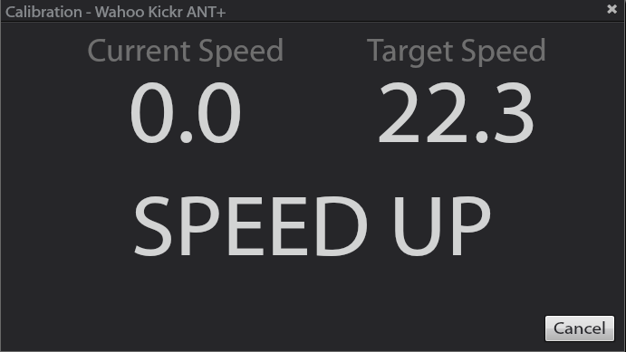

To initiate spindown calibration, just click the “spindown” button or push “c” on the keyboard. The app will start the calibration process with your trainer. Then just hop on your bike and follow the instructions.
Once the trainer is calibration mode spin up to the target speed. In the second screen shot below you can see that you need to spin up to a speed greater than 22.3 mph (it will show kph if that’s what you have in your profile) when on the Wahoo Kickr.

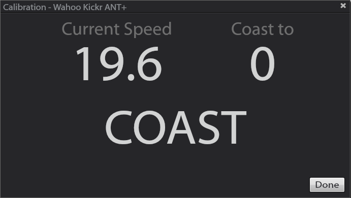

Coast to Finish
After you’ve hit the target speed the instructions will change and tell you to coast. Stop pedaling and let your trainer spin down.

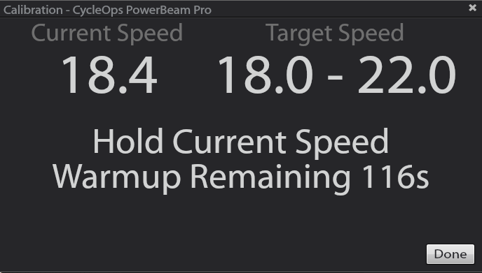

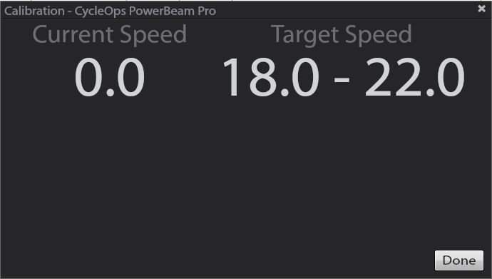

Power Beam Pro Calibration
The power beam pro is a bit different. It requires you to warm up your tire before you do the roll down calibration. Once it’s connected it will tell you to maintain a speed range for two minutes. They do this because the change in heat on the tire can affect your roll down time.
I don’t think you need to calibrate the Power Beam Pro every time if you keep your tire pressure and tire tension the same, and you also stay in a room that’s about the same temperature every time. Personally, I would do this maybe once a week. Although you can certainly do it before every ride. It only takes two minutes.

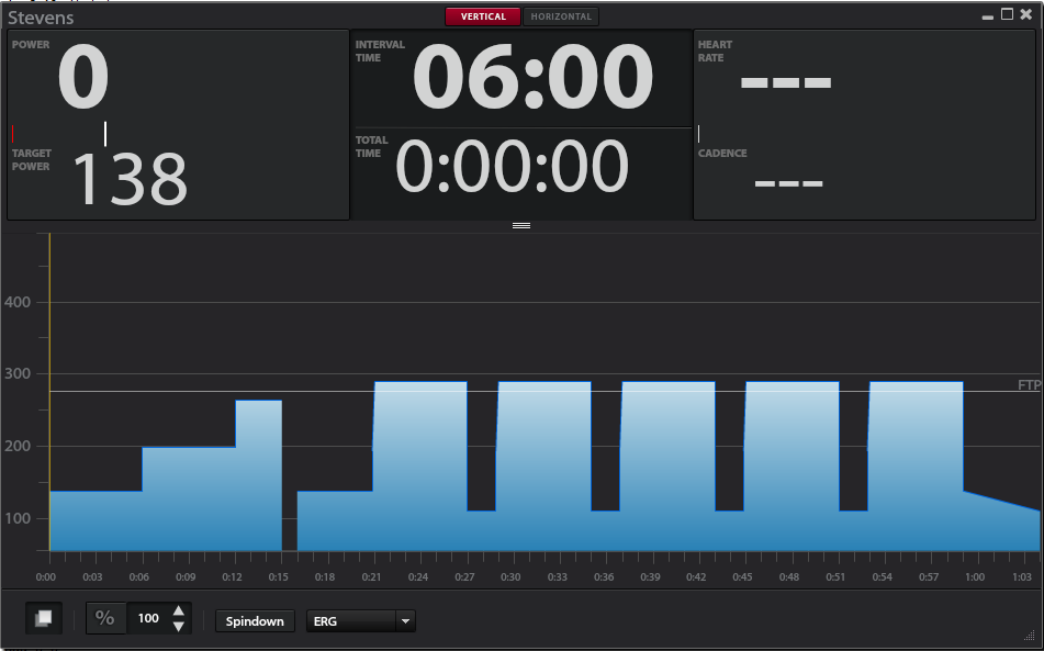

How do I calibrate during a ride?
We’ve added a Spindown button to the main workout window. You can also push “c” on the keyboard.
Once your calibration is complete the calibration window will automatically close and your workout will start up again.
