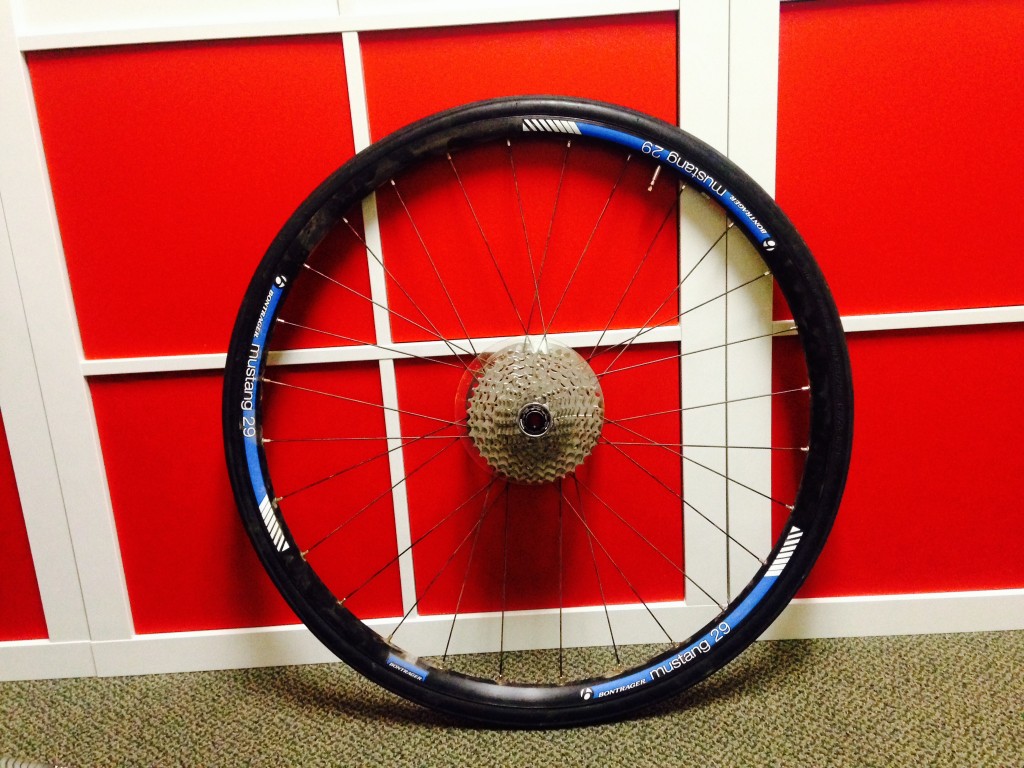

The Tubeless Dilemma
If you’re like me, taking your messy tubeless tire off and replacing it with a slick every time you want to get a good TR workout in is simply not an option.
A good solution is to find a cheap rear wheel and cassette on eBay, a local bike shop, or just ask around at a local ride (you’d be surprised with the amount of spare parts your friends have).
Just like with tires, this does NOT have to be a nice wheel. It just needs to be true and fit the correct cassette for your bike.
Fortunately, brakes are completely unnecessary for this extra wheel. However, if you have disc brakes, be careful to not squeeze the lever if you decide to not put a disc on the wheel.
Sometimes getting a little stopper to put between the pads can be useful if you find yourself grabbing for brakes at the end of a workout.

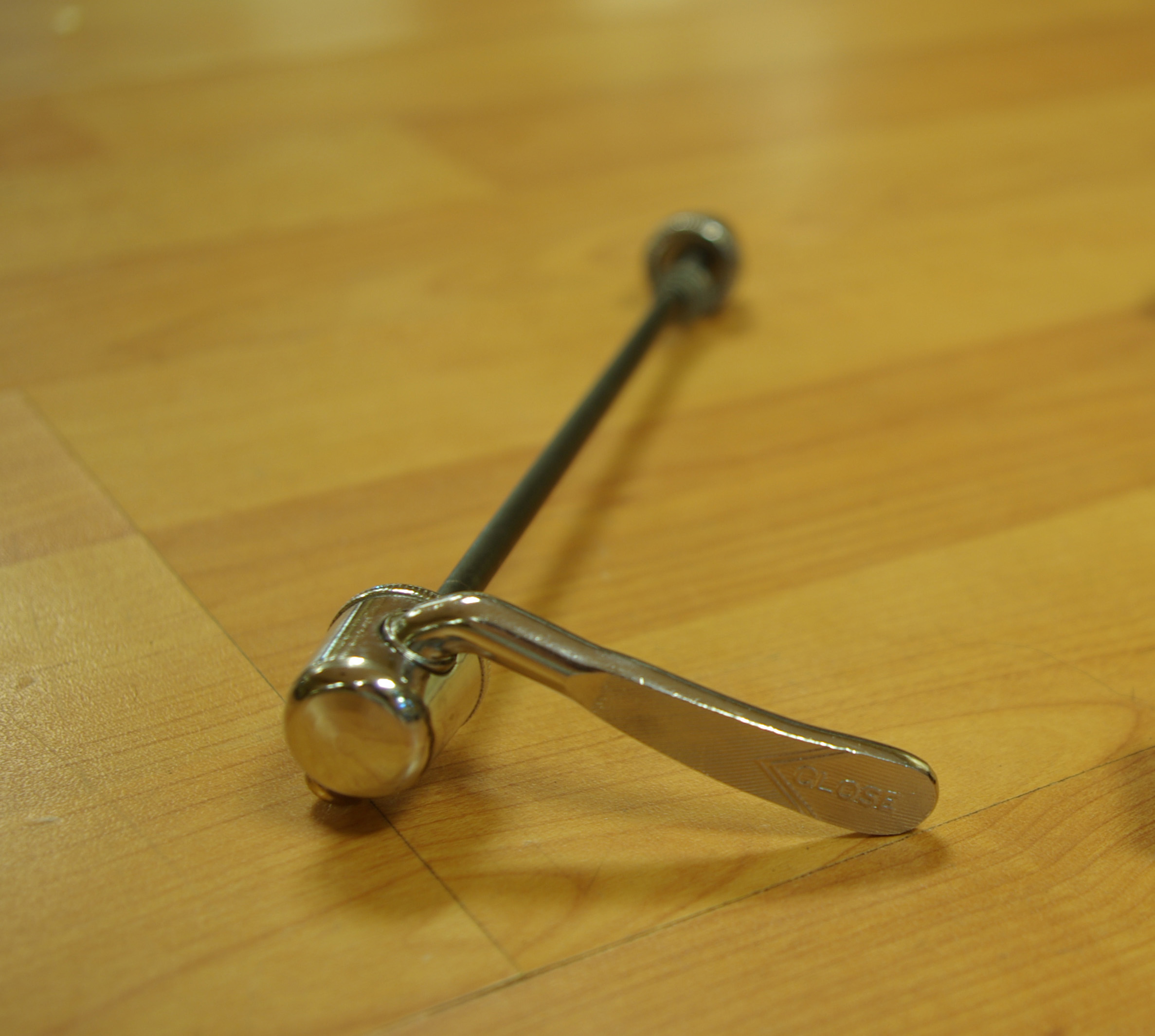

Skewers
Unless you’re riding on rollers or a Kickr, chances are you’re going to need a skewer.
Many times you can get away with the skewer that’s already on your bike, but be careful, as the torque from pedaling while the bike is locked into the trainer can damage your high-end skewer.
What’s the best type of skewer for a trainer? These old-school, bulky, metal ones. They are also one of the cheapest.
Skewer
