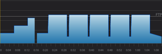

Dicks – Intensive Endurance Workout
Put another way, Speed workouts will make you more powerful, Intensive Endurance workouts will make you more powerful for longer durations, and Extensive Endurance workouts will teach you how to ride an entire 40 kilometers/25miles at or very near your target pace. The ultimate objective is to bring these 3 components together just in time for race day thereby delivering you to the starting line fully capable of sustaining your target time trial pace for the entire race distance.

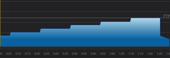

Tower – Extensive Endurance Workout
