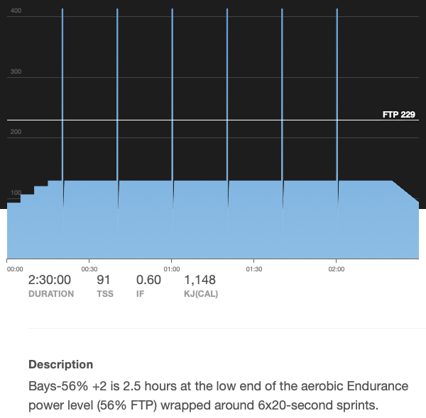

Tonight I’ve got my other new aerobic workout, a 2.5 hour aerobic endurance ride with 20-sec sprints:
May increase % FTP over time, right now I’m starting low to reduce fatigue.
