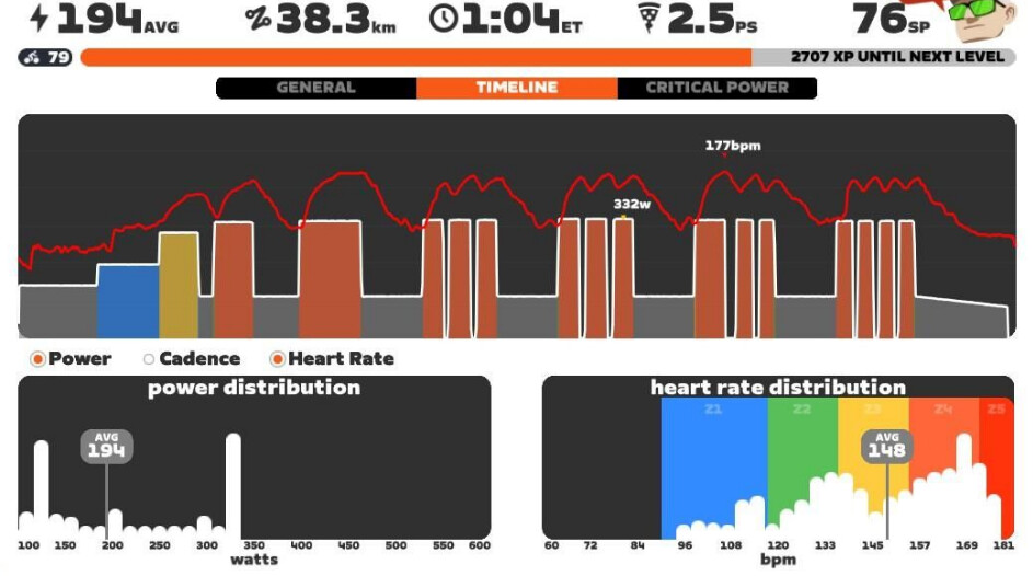

Did “Border” this morning, VO2 max 6.7. Had to intermittent “pauze” the last 4 intervals, does anyone consider this workout as ‘failed’?

Look at your HR trace for the first interval as compared to the others. That first one looks pretty good. I’d say that in the other 4 you didn’t get the expected stimulus and so none of them was successful.

Side note: ERG mode is really not your friend for this sort of workout.

You’re probably right about the ERG mode, but I love flat lines… :sunglasses:

With 4/5 intervals done using bailouts, we’d lean more towards “did not pass.”
