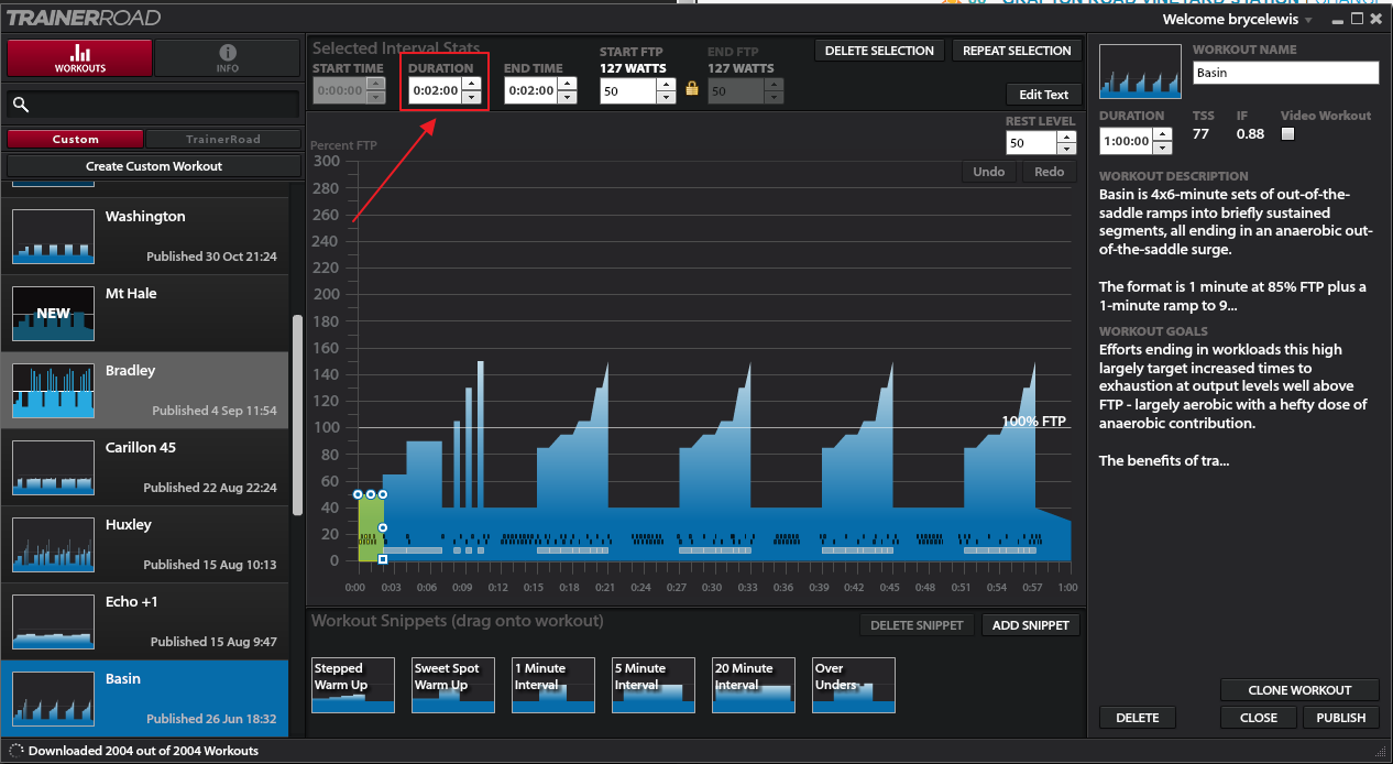

If you click on the warm-up/cool-down interval, you will be given the option to adjust the Start/End time and the duration :slight_smile:

In the screenshot that @Bryce shared, see the box labeled “REST LEVEL”? What % of FTP do you have that set to? Also, where in TR are you seeing warm up / cool down? I build most of my workouts in Workout Creator, and I’ve never seen any part of the ride labeled as either warmup or cool down.
Nate covers the basics of “Rest Level” and pre-defined intervals here in this video. This link will take you to the timestamp where he starts talking about this topic:

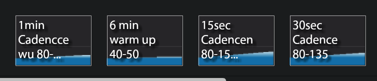

Snippets within Workout Creator is a powerful tool for creating custom warmups. I have about a dozen that I use for warmups, cool downs, and elsewhere when customizing workouts. Below is a screenshot of 3 cadence-based warmups (15, 30 and 60 seconds) as well as a 6min warmup of 40, 45 and 50% FTP.
