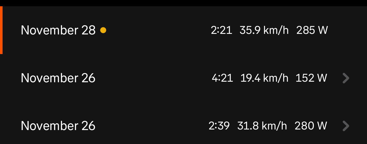

I got 5km/h faster just by lowering my head today lol. I will try with right jersey in the summer and see how fast I can go.
That’s great… but there’s no way that simply lowering your head would increase your speed by 13%.
At those speeds that would mean that lowering your head reduced your CdA by ~50% from ~0.6 to ~0.4.
Unless you’re Mr Mackey from South Park, this additional data point just raises further questions in my mind, mmmkay?
Only getting 19.4km/h off 152W , either you have a drone parachute behind, or the power number isn’t right.
