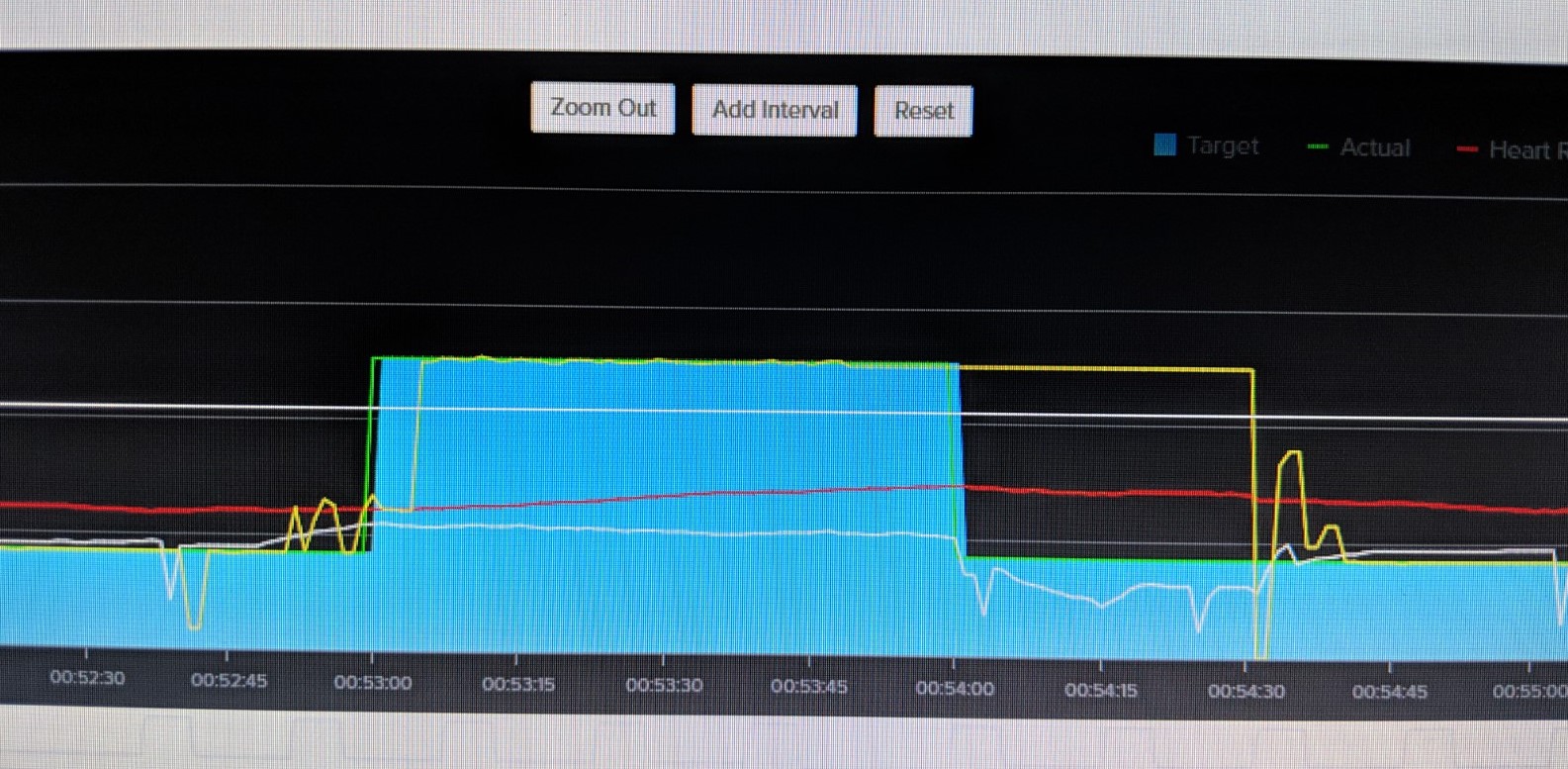

I’m having the same issue’s. I’ve worked with TR Support (which was great) but unfortunately, we couldn’t resolve. Bluetooth is a tough troubleshoot.
I’m using a Kinetic Smart Control (current firmware) with my PC. I have the BlueGiga on a dedicated USB extension chord sitting right under my trainer. I’ve eliminated all bluetooth traffic in the room. It’s as clean as I can get it.
I have 2 issue’s:
The interval will end but the ERG mode will not release so my target may be 85 but the watts are still 200. In this scenario I have to let the ride pause and then it reconnects.
The second is that the connection drops completely and nothing gets it back, ride is cooked.
I believe Bluetooth and ANT+ use the same frequency so I’m confused why only BT drops and never ANT+.
I get these hiccups 1-2 times a week. I get tiny connection drops almost every ride. (ride pauses for a split second)
I’m at a lost as to where the connection drop is happening.
