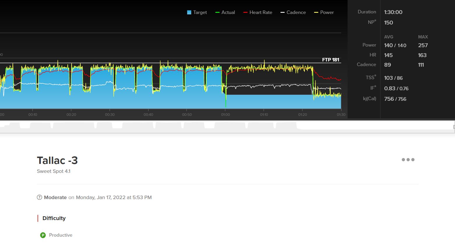

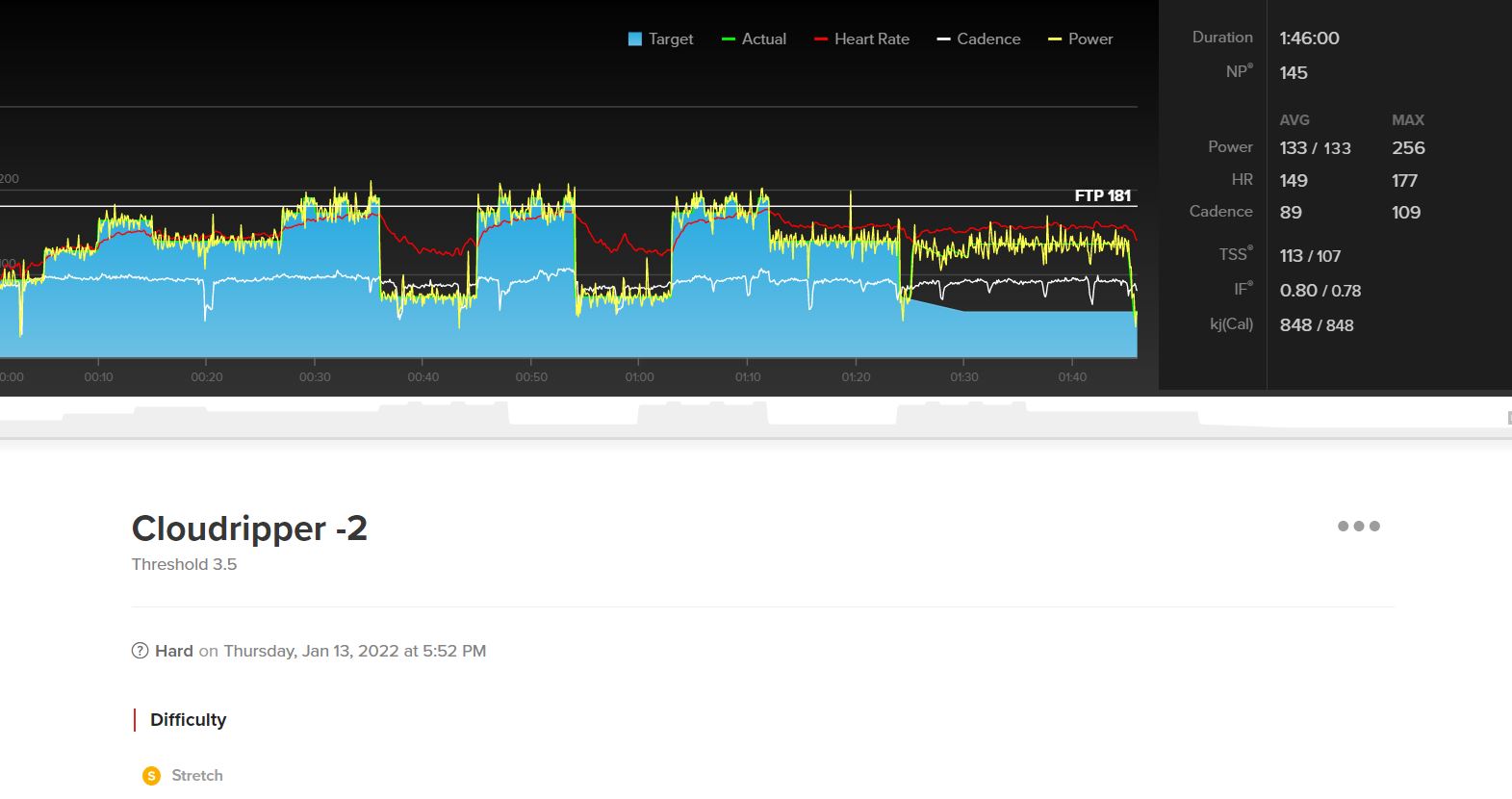

I have a big dilemma: I restarted training after a long off period and after a few easy workouts I retested resulting an FTP of 181 (2.78 w/kg)
I’ve built up a plan with Plan Builder for “Flanders Sportive”, which I will attend in April, and I noticed that the workouts seem to be easy.
I had no problem finishing some stretched +1.4 Threshold and +1.4 Sweet Spot workouts, not to say about Productive ones. For example, yesterday I had Tallac-3 (3x15-minute efforts between 86-92% FTP with a couple brief, 30-second intermediate recoveries during each long interval) and after the intervals I rode another 20 mins or so at 85% of FTP and still rated the workout moderate in the survey.
I’m not support but I would ride the actual workouts (not your 85%) extra and do the survey. AT should kick in and ramp things up for you pretty quick. But we f you rate the workout as moderate and that is what it is ‘meant to feel’ you probably won’t see the increase you need. Score them as 1 if easy, and if you are tacking on your own intervals the prescribed workout was easy. Alternatively you could pick a workout you think you can do, probably in stretch at least and rate it honestly.
