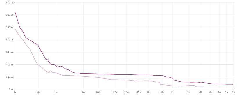

You can also measure your progress quite well using a power curve. Here is me at the beginning of the season verse later on. You can see I am faster in every single time range from earlier in the season and can hold over 200 watts for an hour now verse 137 at the start of the season.
