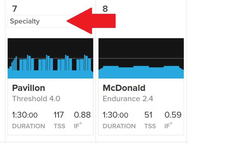

You can modify your plan so you don’t have intervals on Saturdays. I changed mine to doing intervals on Fridays. If you click on the start of the training block in Calendar, you can go in and edit the type and duration of workout for each day of the week.

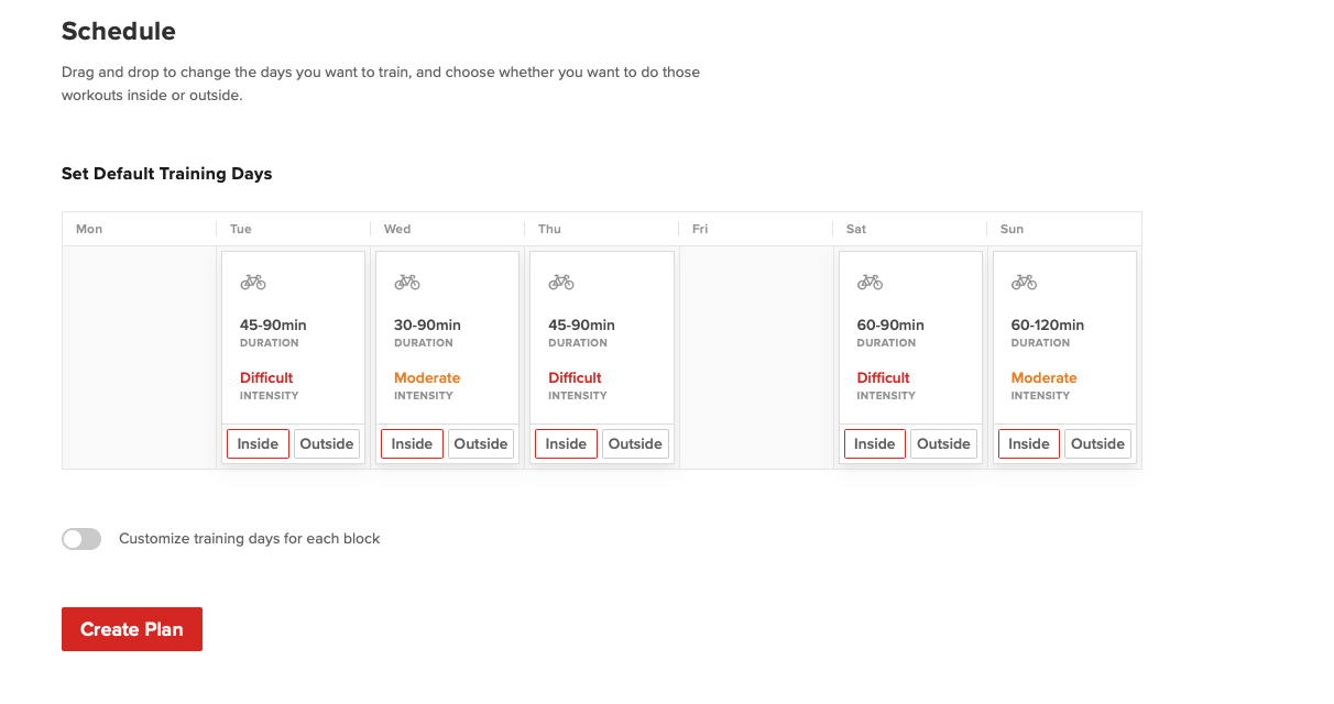

How to customise your scheduled Workout days:
  1. When you are going through Plan Builder, you will get to the Schedule section. Simply drag and drop the Workouts to the days that suit your schedule. See below.
  1. Once a Training Plan is on your Calendar, go to the annotation that marks the start of the Training Block, as @BrianSpang has helpfuly shown below:
That will show you a box like the one below.
You can drag and drop Workouts to the days that suit your schedule best.
From here, you can also change your Plan Volume if you choose to do that.
Once you have made the changes you wish to make to your Plan Volume and training days, click “Update”.

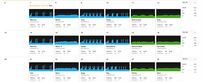

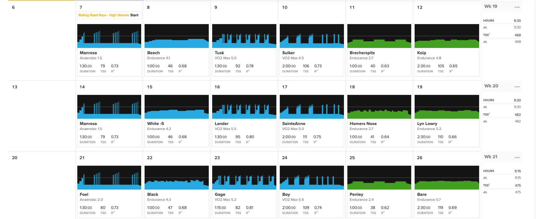

So I just scheduled the Rolling Road Race plan. Not that I’m planning to race, just trying to peak this summer… For the fun of it…
I have switched friday and saturday, which makes thursday and friday back to back interval days. I will probably have two long group rides most saturdays and sundays. Like +2-3 hour rides… My schedule looks like this attached example, just with the following week being a recovery week, followed by a more or less identical 4 week block:
Do I just let adaptive training take care of things from here?? :blush:
Ooooof, that’s a lot with two Group Rides. I’d suggest you switch to a Mid Volume plan (at most) to prevent back to back interval workouts.
Then Adaptive Training will take care of the rest, to ensure your training load is productive and you make progress without becoming burned out :+1: (edited)
I would say move to a masters plan with your interval days during the week. Then have weekend fun but be careful how fatigued you are for the hard days.
