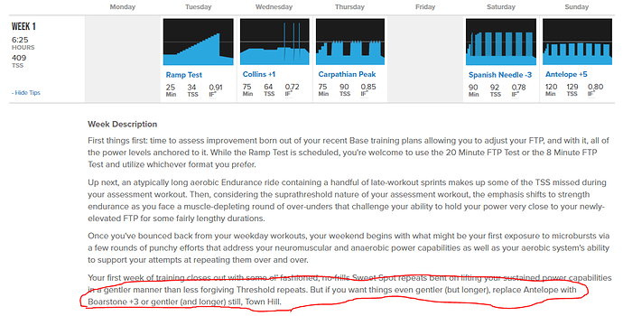

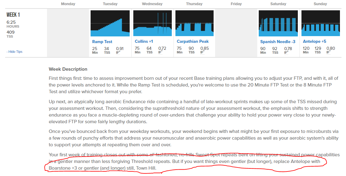

I don’t think the program allows for enough long endurance rides and people don’t do proper endurance rides outside (spend too much time in active recovery or coasting) on their LSD. I think @Nate_Pearson was onto something with his high use of Baxter.
I should have typed, “includes.” It certainly allows
Many of the plans default to the Sweet Spot rides for the “long” Sunday ride. This is done with keeping training time on the trainer to a minimum. Most people don’t like or tolerate rides over 2 hours on the trainer.
But if you read the Weekly Tips, you will see recommendations of longer, Endurance zone rides (instead of the SS ones). These can be done inside or out, and most are 2.5 hours or longer.
Point being that they do offer solid suggestions for those that want the longer rides. It just isn’t the default.
Agree! Many opt to not do the longer endurance trainer ride or don’t do a proper outdoor endurance ride and run into the issue being discussed here.
