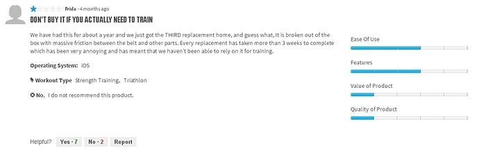

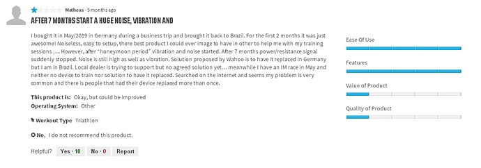

I purchased kickr2018 in July 2019
Only after the first month of use, I encountered the problem of bearing wear
Until now 2020 June
People continue to encounter bearing or vibration problems
wahoo Is also sending kickers with design flaws to consumers
kickr2018 Is no longer a durable product
kickr2018 Whether to make wahoo gradually become Theranos ( bad blood)
