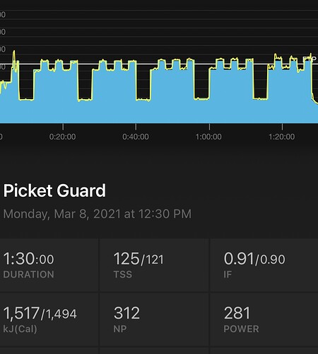

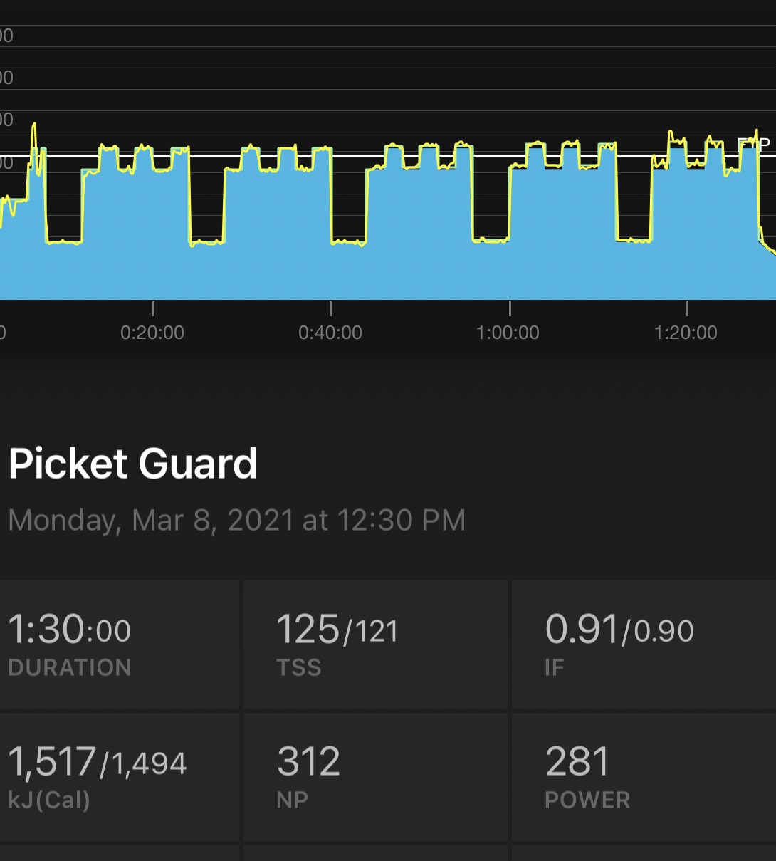

I likely found the issue for me…a big discrepancy between my Stages and my Kickr Core. I hadn’t done a spin down on my Kickr in at least 3 weeks and I’m pretty sure last time I actually shifted down the cassette to get to 24MPH (which I only remembered doing tonight during the spin down below). This would coincide with the start of a new block and when workouts started really feeling immensely hard for me. I don’t really pay attention to the workout, I just get on and pedal. That approach created the opportunity for this error.
In the middle of my workout tonight, I switched to using my Stages for power instead of the Kickr and 250W immediately felt like outside, whereas 250W from the Kickr felt like a bunch more (like 325 or 350W on the Stages). I immediately paused and calibrated my Stages as I had before starting and then did a spin down of the Kickr. I wasn’t using the same gearing in Erg mode for the spin down as I was for my workouts…spin down in the smaller cogs and workout in the middle of the cassette. After the spin down in the same cog as I workout in, the Stages and Kickr felt the same. I left Power Match on (which I should have been doing to begin with). This would then lead me to believe that yes, my FTP is higher still. I’ll Ramp again on Thursday and report back.
TLDR: I’m a moron who now has a bunch of useless statistical history.
