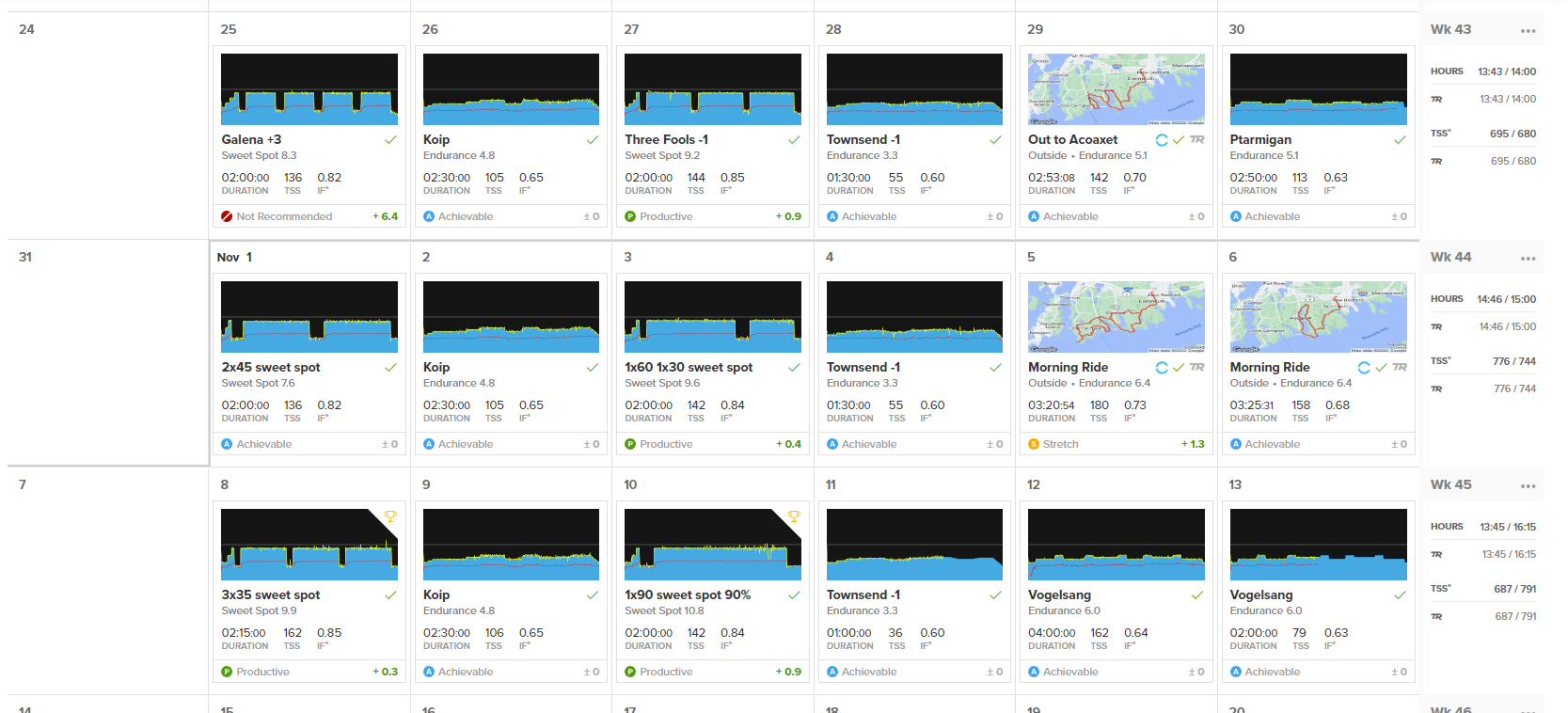

I def use TR 6 days a week, this was version of SSB recently
I hadn’t done sweet spot but I knew I was fit so I jumped right into 4x20 and with a combo of TR and some imported ones I made, did my own thing. So in a sense i progressed faster but still retained a lot of freshness with this structure (I think). I think TR is still great for workout library and importing and their power match is still the best.
