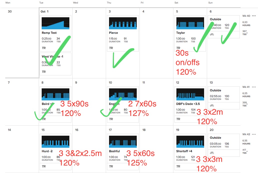

I was doing HIM build and noted that after the last FTP update the VO2max intervals got significantly harder compared to earlier. all this even though I was doing similar VO2max workouts before in SSB2 and a modified HIM base (I substituted similar VO2max workouts as in SSB2, including spencer +2, kaiser, shortoff +4, …).
In particular, while I was getting through the workouts at the prescribed intensity, I felt more soreness, went right up to HRmax and had 2 workouts where I absolutely needed to backpedal because I bonked. life stress added a bit of spice to the interpretation of what was going on.
I really felt my legs when I had VO2max workouts combined with Julius Caesar in one week (couldn’t do long ride of HV plan b/c weather) - i.e. Matthes +1 then JC +3 just 2 days later, or Mist-1 then JC +4 later in the week.
after revisiting the discussion in the podcast and what you guys wrote here, I should have recognised this earlier and reduced intensity a few %. would have probably left me fitter for the next workouts of the week and not significantly reduced the training impulse.
