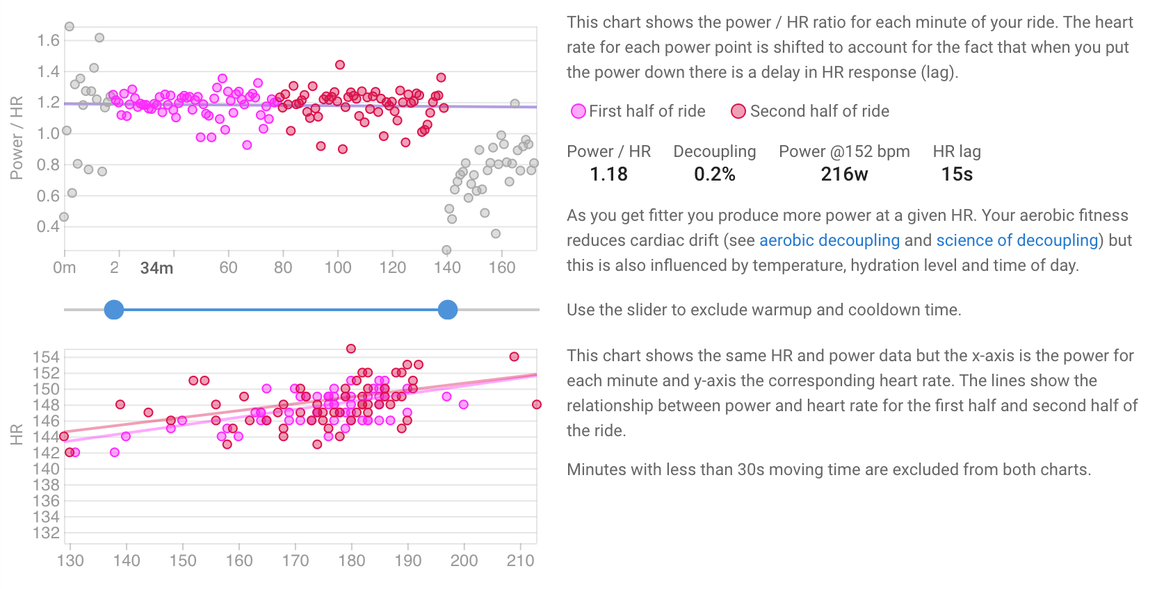

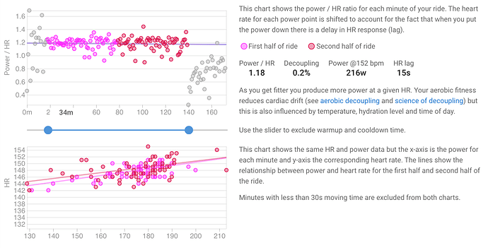

These have all been done now. The “whole ride” decoupling charts now support warmup and cool down times making them a lot more useful.
Brilliant! I just used the new warm-up/cool-down sliders to fine-tune how aerobic decoupling is calculated from the workout and it’s intuitive and simple to use. Well done!

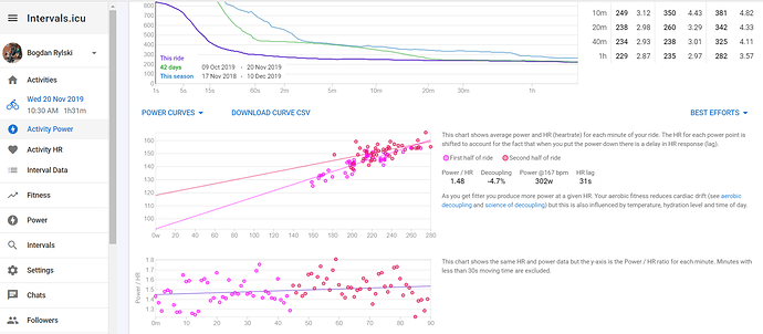

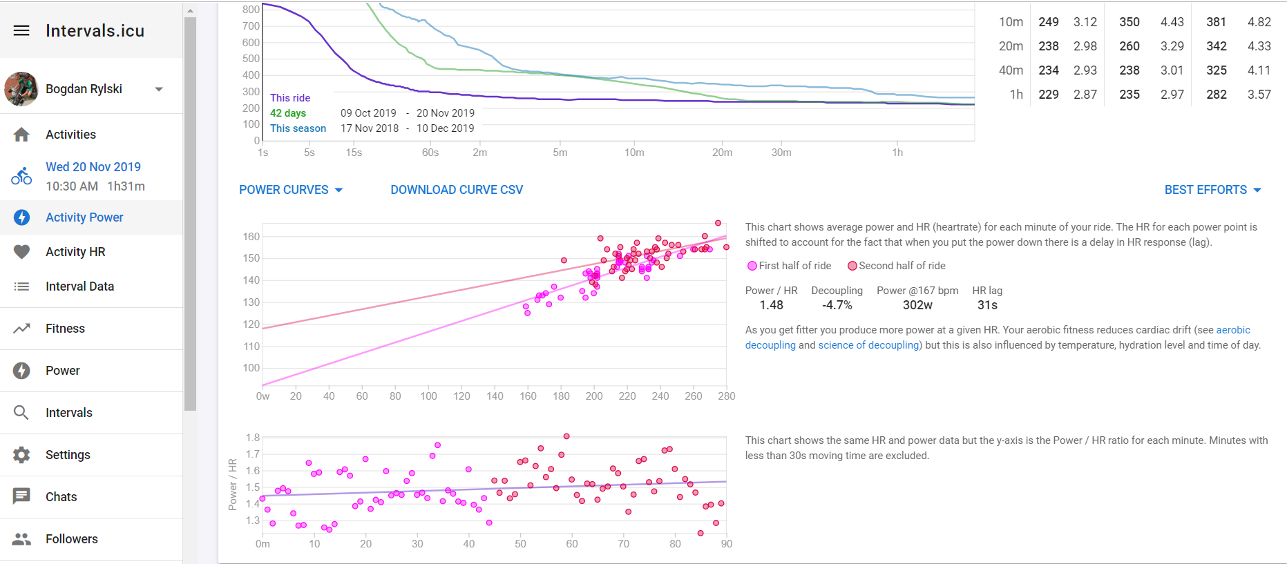

Trying to figure out how to do that but can’t find those sliders.
It spits out a number 5 watts over what I train at right now (3% give or take). I think with the model it uses the more inputs, the better it gets it.
They are between the 2 decoupling related charts on the activity power page (blue in this screenshot):
