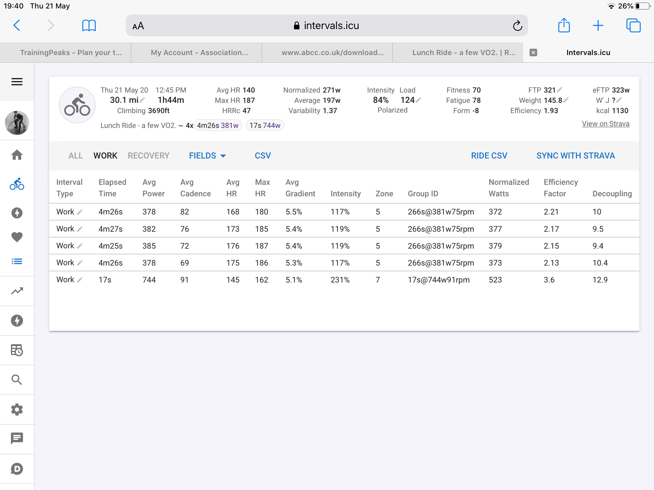

If you’re doing intervals and look at efficiency factor, what is a good value?
I’m not sure there’s a good EF value, just good relative to yourself. During longer sweet spot intervals, for example, I’ve been at 1.68-1.7 generally for my EF. I’m on week 5 of SSB1 HV and that’s been pretty consistent since the first week, and for me that kind of tells me I likely won’t be bumping up my FTP for SSB2. I’m not an expert by any means, but if that EF went up consistently past, say, 1.72, after being at 1.68-1.7 initially, I’d probably see that as a sign of progress.

Efficiency Factor and Decoupling
I like to keep things simple in intervals, and most of the custom factors being built in, while cool, don’t end up getting used for me.
That being said, efficiency and aerobic decoupling are two topics that would be super interesting for me to track in workouts and over time.

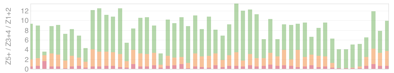

(Small?) Feature request, though if it doesn’t make sense no worries there:
The classifications on the totals page are super interesting, but they don’t really reference the ranges for each of the classifications (polarized, pyarmidal, etc). And because Alex’s FFT link still seems to be pointing to a website under construction, I can’t prescriptively say ā€œhrm, I need to decrease my Z3/4 by this much to be in a polarized training state.ā€ for example.
I don’t know how to put that information there or whether it’s worthwhile, but it was something new that occurred to me.
Not sure if its the answer you are looking for, but I think I have heard that zone distribution models are more descriptive than prescriptive. Meaning that they are not necessarily meant to be followed ā€œto a Tā€, they just describe training in general terms.
Just to echo @hubcyclist, efficiency factor is looking at raw watts and raw heart rate, and those two variables are hugely individual. My FTP is about 200 and my max heart rate (recently) is around 190, so my efficiency values are going to be way lower than somebody with the same heart rate range but a 350W FTP, or somebody with a 200W FTP and a much lower heart rate. It’s not a ratio you can reasonably compare between individuals.

Makes sense to me! Then I suppose I would be interested to see what rules are defined for the categorization. But fair point; it’s not a big deal either way. :slight_smile:
I adapted the rules I got from Alex a bit to better fit people who do 12h a week sometimes. But I don’t think there is a ā€œstandardā€ way to do this. Here is the code:
let ans
if (s3 > s2 && s3 > 0.499 * (s2 + s1)) ans = HITT
else if (s3 > s2 && s1 > s2) ans = POLARIZED
else if (s1 > 3.99 * s2 && s1 > 3 * (s2 + s3)) ans = BASE
else if (s1 < 3.01 * s2 && s1 > 1.4 * s2 && s2 > 1.4 * s3) ans = PYRAMIDAL
else if (s1 < 4 * s2 && s2 > 0.5 * s3) ans = THRESHOLD
else ans = UNIQUE
s1 = Z1 + Z2, s2 = Z3 + Z4, s3 = Z5+
Okay, that makes sense. Thanks for sharing your logic behind the classification!
