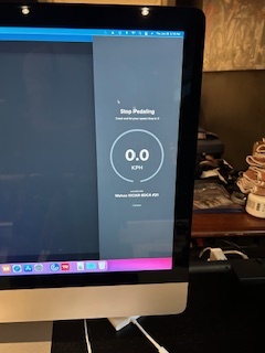

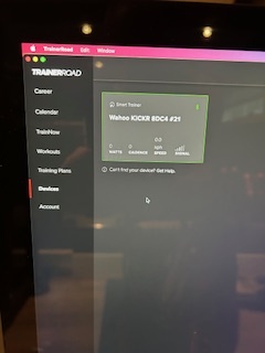

The wahoo trainer is connected to the trainer road app on the computer. The computer doesn’t seem to control the resistance on the wahoo trainer in erg mode. Trainer road is reading the watt output from the wahoo but the TR program is not controlling the wahoo.

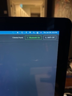

  • Connect devices only using Bluetooth (turn off ANT+ on the Devices tab of the TR app).

I have done everything you said in your last email but still ERG does not control the wahoo.

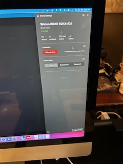

I even tried to recalibrate using the trainer road program and doesn’t seem to finish the calibration. It looks like it hangs up on the spin down after it gets to zero.

When connecting your KICKR, in the settings, click the Resistance button and then the ERG one again.
Note: Depending on what KICKR you have, you may not need a calibration. But if it does, let’s try doing the calibration on the Wahoo’s app. More info here: How to calibrate a smart trainer

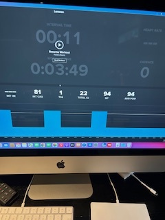

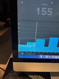

I thought the problem was solved but when I did a regular workout this morning. Unfortunately it was back to the same old problem (the ERG did not control the wahoo).
