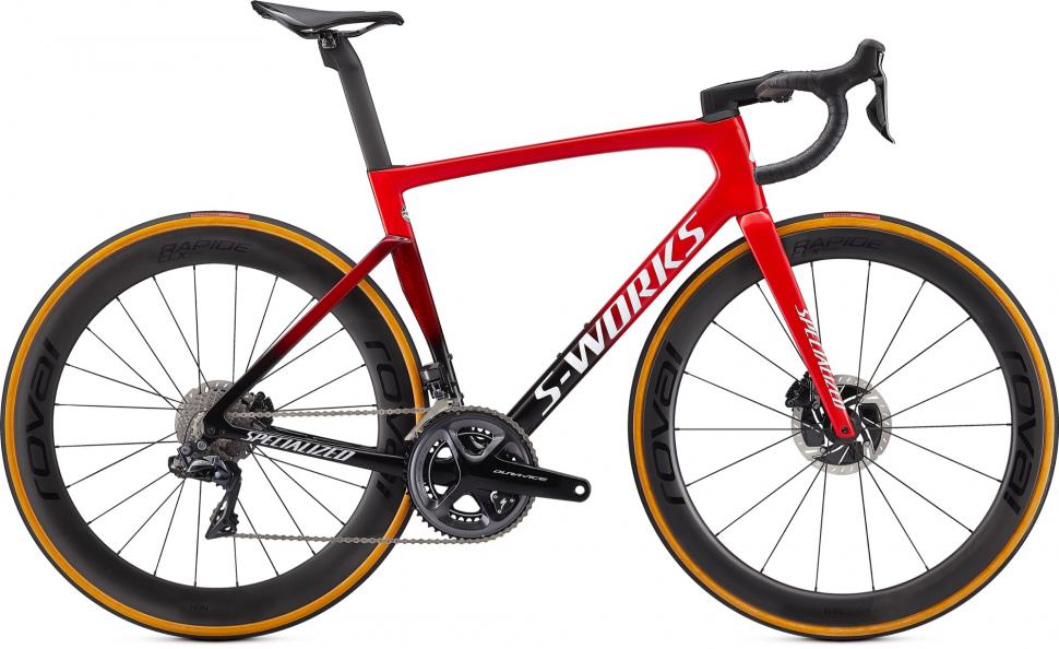

Tarmac SL7 Release date
Nice. What’s the spec?
The bike is a pro-edition. With ultegra di2 ans aerofly handlebars
All you need now is the turbo cotton tyres? Although i love the S-works black and red, I adore my Pro. Especially when you can see the carbon under the blue in decent light.

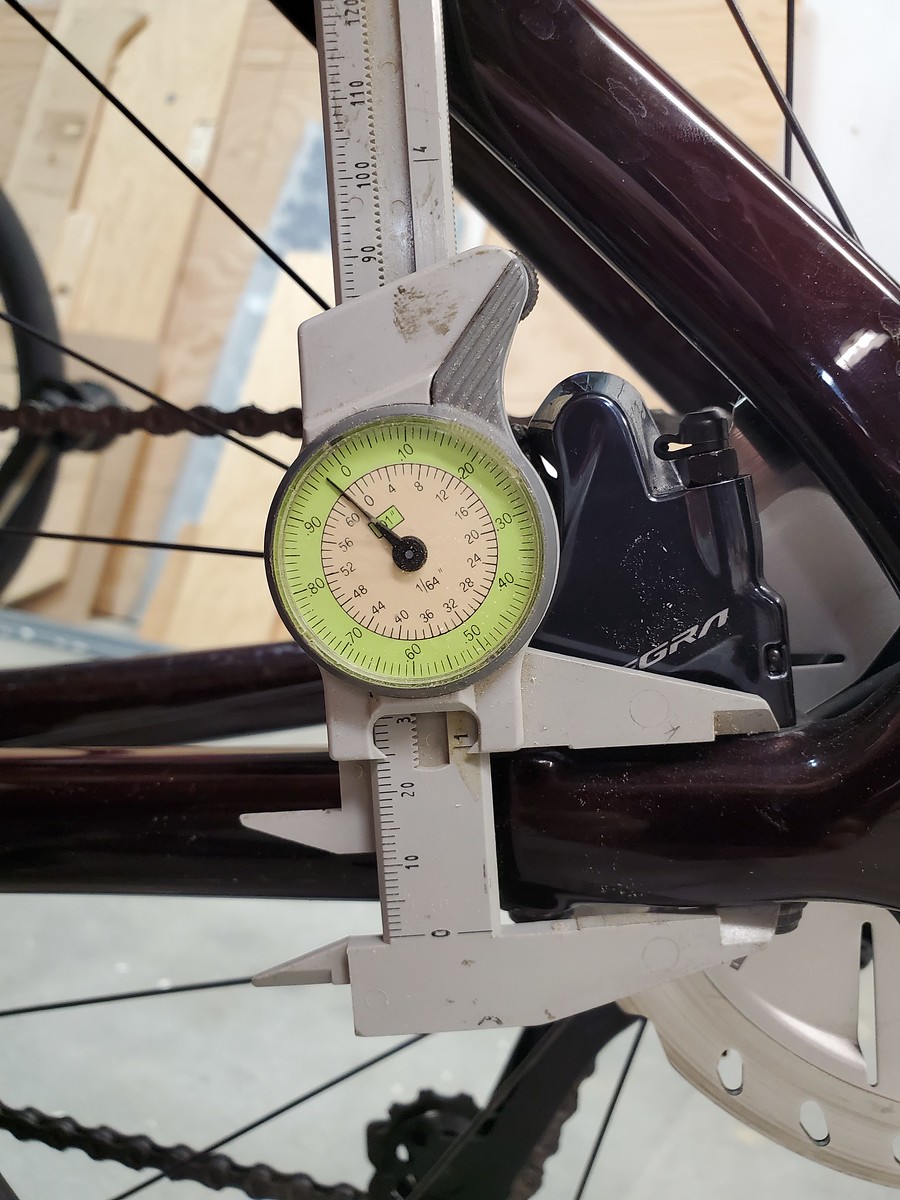

Hi All,
I’m trying to determine what size mounting disc brake mounting caliper bolt is needed for the Shimano Dura Ace rear caliper for the SL7?. It appears they come in different sizes based upon chainstay thickness of 20mm, 25mm and 30mm.
Does anyone know which bolt to use or can measure their Sl7’s chainstay thickness with digital calipers?
Any help is much appreciated.
This? .97 inches, or 25mm
Hi TriSherpa,
Yes, that is what I am looking for, the thickness of the SL7 chainstay! This info is not in the SL7 manual. The chainstay thickness determines which caliper mounting bolt to use. I am trying to see if I have the necessary parts to transfer over from my TCR. If anyone is wondering, the TCR chainstay thickness is also 25mm, so it should use the same mounting bolt.
Thank you very much for taking the time to measure!
