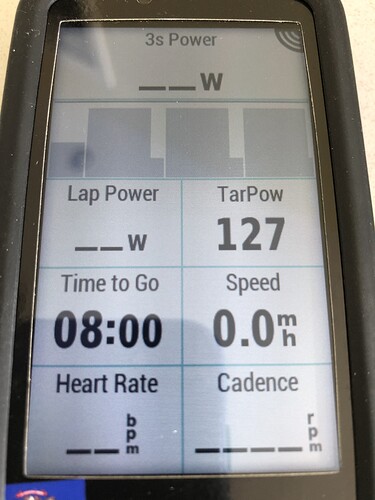

I’ve gone away from using the Garmin Target power field and now use the target power IQ Connect field, it’s much easier to see and gives you the exact number the app says for outdoor workouts for work intervals. It tends to show a lower power for rest and warmup intervals, but that’s not something that bother me since they’re not work periods
Nice. The TarPow field located third row on the right, correct?
Yep!
I use this as well. Just like it use to be!
Is it this one?
Yes. I actually have the visual range one @bbarrera likes on my screen also. Depending how intense things are, I look at one or the other
