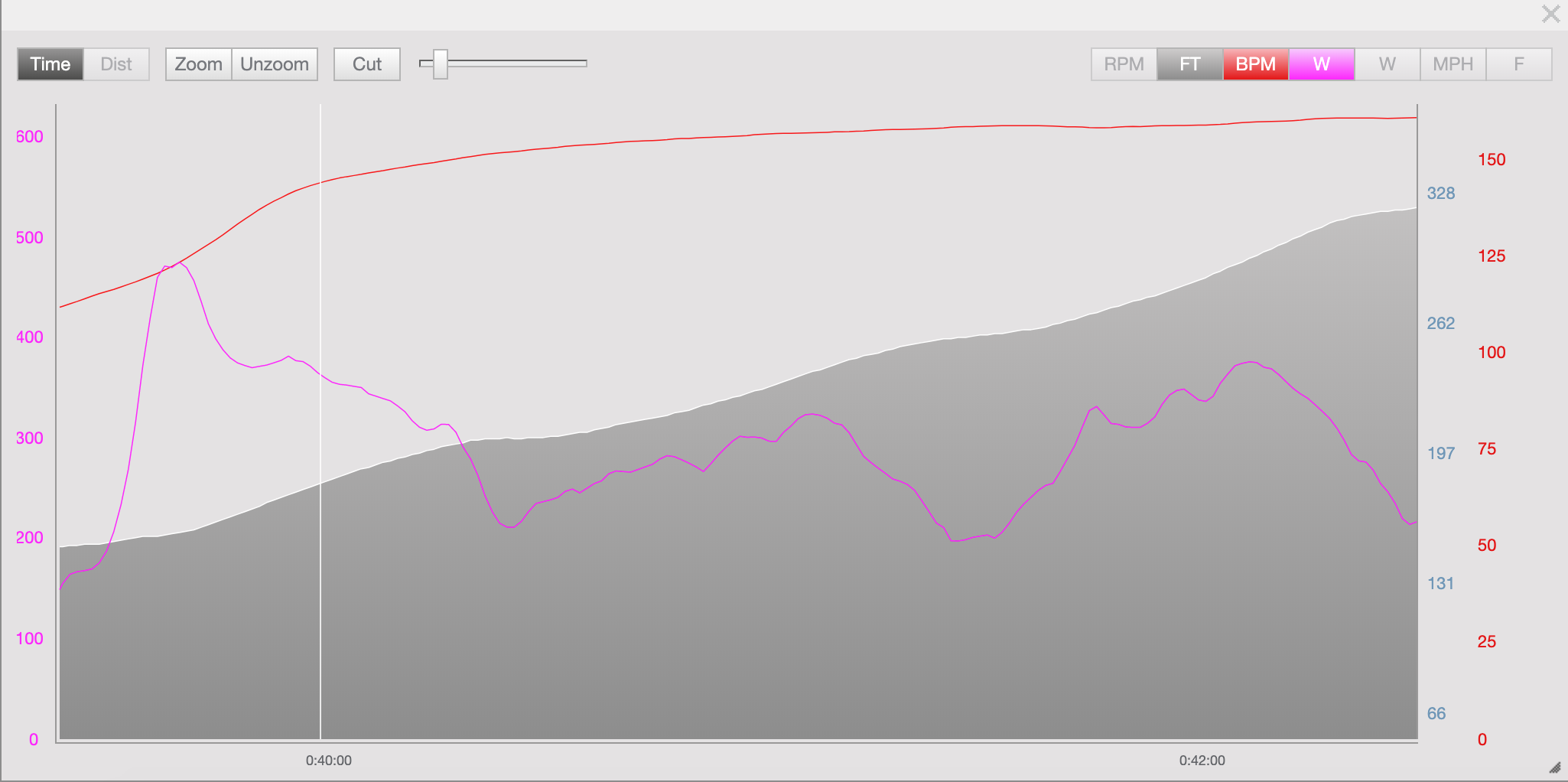

I’m not sure how these things work, and have a Bolt myself, but when I’m doing workouts outside, my climbs are far too variable to stay remotely close to +/-6 watts near my target.
I look at my 5sec watts to make sure I’m not going off too hard or too easy, but my main metric is average lap watts, which I use to gett up / down to target and then try to hold it. I also look at HR, e.g. during vo2 efforts I’ll try to get to and hold 90%+ max HR.
For example, here’s a 3min interval in an attempt to do Spencer +2 outdoors on my local climb, which has 3 steep ramps separated by flatter sections:
Unless you’ve got long and incredibly even climbs, I don’t think the aim should be “make it as much like ERG mode as possible”.
