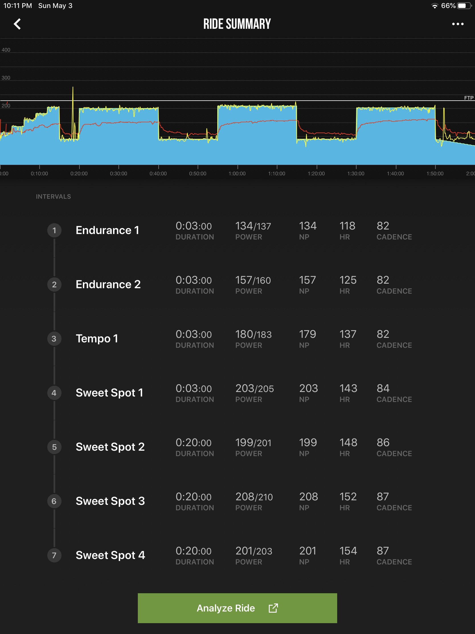

Just got mine last week, fingers crossed that the belt and everything else keeps working — right now it all seems right and wonderful. I left the fans off, though, in favor of existing cooling setup.
BUT: I’m also getting 2-3 watts below target for each interval. Below is my data for Hunter, can’t imagine why a 20 minute flat interval shouldn’t come out dead-on with relatively stable cadence. I assume most erg mode setups are spot-on?
The ERG firmware undershorts by a few watts but is significantly improved from the previous version. Just bump the intensity one or two percent if it bothers you.
