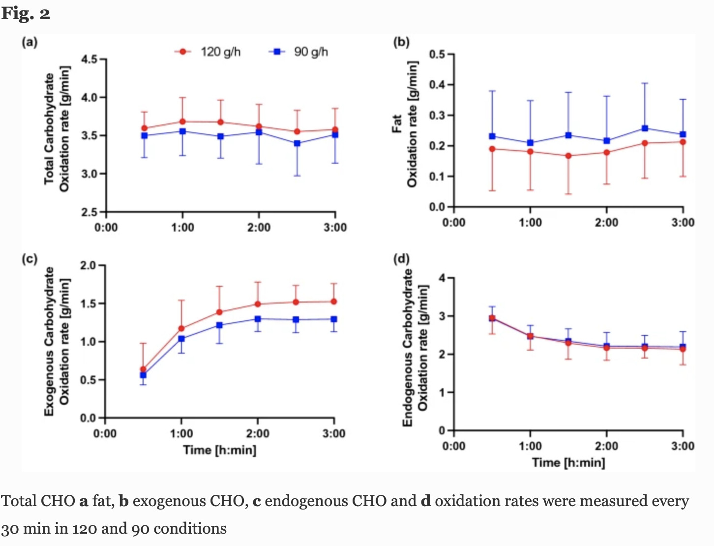

You still burn the same carbs from muscle stores. No matter 120g/hour or 90g/hour. So no muscle glycogen sparing from going 90 to 120.
So no point ingesting more than 90g/hr? At least based on this study?
But will burn more carbs from what you are drinking.
From my quick skim of the start of the paper, I don’t think they were evaluating/comparing performance - ie they were focused on measuring exogenous/endogenous carb usage. (see quote below.)
It’s possible that 120g/hour enables higher performance than 90, but that would take other experiments to confirm. I think some of the older studies at higher than 90 were using the 1:2 ratio, not the 08.:1 used here.
Since it looks like the 3 hour exercise sessions were at a fixed output, the energy used should be the same, so I guess it looks like they used less fat in the 120g/hour case?? Maybe that’s discussed later int he paper. There clearly seems to be more work to be done to have a good understanding of the limits of carb usage, and what rates are optimal for different situations.
Thus, the aim of the present study was to compare exogenous and endogenous CHO oxidation rates after ingesting CHO at the widely recommended rate of 90 g hāˆ’1 in 1:2 (Burke et al. 2011) with the rate of 120 g hāˆ’1 in 0.8:1 (fructose to glucose-based CHO ratio) as has been more recently advanced (Hearris et al. 2022 and Rowlands et al. 2015).

I’m still wading thru it, of note:
The exercise consisted of 180 min of cycling at 95% GET (mean 256 ± 16 W, range 235–295 W).
From my point of view that’s a high power output for 3 hours. It’s what I can do for about an hour at threshold. My best 3-6 hour power is 175-195W. That was fueled around 70-90 grams/hour. I’ll run some calcs later, maybe I could push harder with more fueling, or maybe I’m ftp limited.

so in essence you get more carbs burned thus more energy at the lower ratio than the higher ratio, though they still saw utilization of endogenous carbs in both cases and since they suggest no sparing in either case it means the lower ratio is still the better from an energy input point of view.

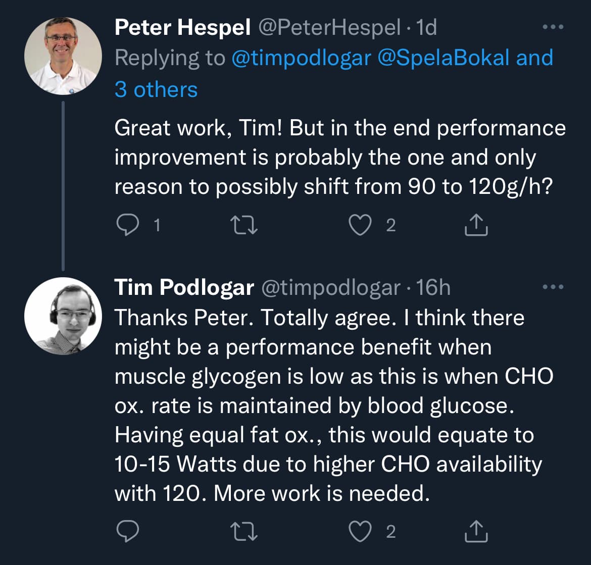

Hot off the presses, it was published that same day. Saw Tim Podligar tweet.
The tweet from the man, the myth, the legend himself. https://twitter.com/timpodlogar/status/1557681283370713091/photo/1
This answer is what caught my eye:
@Nate_Pearson & team, good on you.

Going to back to the study now, I don’t know my gas exchange threshold or respiratory compensation point. So I want to roughly translate that to % IF so I can possibly use it. In the study, 3 hour power was at 95% GET. Lets be sloppy and use 328W average RCP as roughly FTP (its not), and exercise was performed at average of 256W. So that’s roughly a 78% IF, really really rough the exercise was 3 hours at low tempo. Right?
Well 256W for an hour would be a good day for me, a really good day would be 270W for an hour. Three hours? That’s more like 175-200W and 65-75% IF. This year I’ve had some strong 2 and 3 hour endurance training efforts around 75%. So roughly similar intensity as the study, not the same absolute energetic requirements but assuming some linearity I might be able to use some ratios for a rough broadside approximation for myself.
So again, going out on a limb, lets assume at 75% my ratios of exo/endo carb oxidation would be vaguely similar to those in the study:
Again those cyclists have higher vo2max and absolute power, burning a bit more absolute, but since they were lower tempo and I was at zone2/tempo border humor me that the ratios might be considered a ceiling for my effort.
So from the study graph I posted above, lets ballpark my endogenous carb oxidation rate at 2g/min, or 120g/hour. So for 2 hours that would be 240g. Clearly that starts to empty the tank - the 400g stored in muscles at start. And it gets dicey at 3 hours for sure.
Going with these admittedly pseudo random ballpark numbers, what’s to gain increasing from 60g/hour Roctane (not sure of ratio) to 120g/hour carbs at 4:5 fructose-to-glucose (0.8:1) ratio?

Okay that’s what I thought. Here was my question to @timpodlogar about that:
I look forward to his response. He’s probably asleep right now, given that he’s in Europe somewhere.
