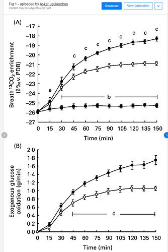

I think perhaps the best evidence, regardless of what may have come out recently which I may not have read yet, is one of Dr. Jeukendrup’s landmark papers.
Figures below are from that paper, in 2004.
The trends are what are most striking.
They’re indicative that with higher fueling rates, and longer durations, higher oxidation rates would absolutely be achieved.
Pair this with the recent study showing substantially reduced muscle damage comparing 90g/hr to 120g/h in mountain marathon runners, and you’ve got a pretty nice case building that we don’t yet know max exogenous carb oxidation rates because there hasn’t been sufficient study. To call a “cap” now, would be unwise.
The cap is higher than present research shows.
Endogenous oxidation rate increasing up above 1.7g/hr:
Blood glucose level falling:
Ride time was only 2.5 hrs.
Push it out longer and give those same people more carbs and you’ll see higher max exogenous carb ox rates.
Just to be clear, I’m grateful for Dr. Jeukendrup’s work. He stands as one of the greats in this field.
He’s been researching this stuff since before I was born. 90g/hr in 1985.
