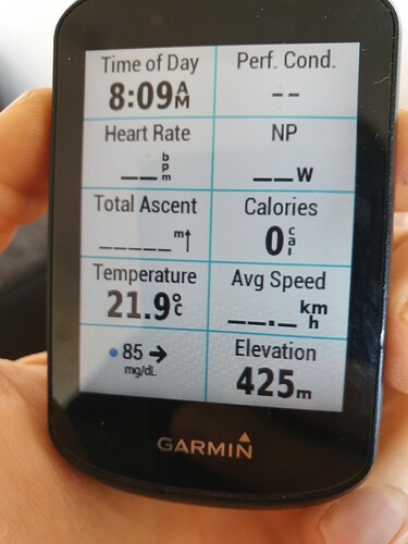

This is not so straightforward to gauge for the reason that activity level and intensity, say an interval or rest phase, will also change the monitoring level. Going for a walk simply can bring it up but then quickly down, so the temporal change is rather hard to understand at first. However, it can help you in this direction. I used it for my morning workout to gauge how much some of SS work needs.
Picture below shows how it looks on an edge 530.
My Brother in law uses the G6 and he says there is no delay either.
Thanks @admigo really appreciate an actual pic too.
What do you think about long sustained efforts, like 1hr + efforts where you want to keep an almost constant power and consistent stream of fuel intake - do you think it would helpful to show if you fuelling strategy for that is falling apart and you maybe need to up the intake, or even ease off the intake as you’re well loaded for the time being?
