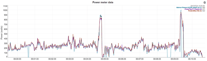

Seems like you had a bad experience with the Kickr Snap, possibly an older model, a firmware issue or your power meter was off. DC Rainmaker says otherwise and the Kickr Snap followed his other power meters quite well.
(Wahoo’s New 2017 KICKR SNAP Trainer: Hands-on | DC Rainmaker)

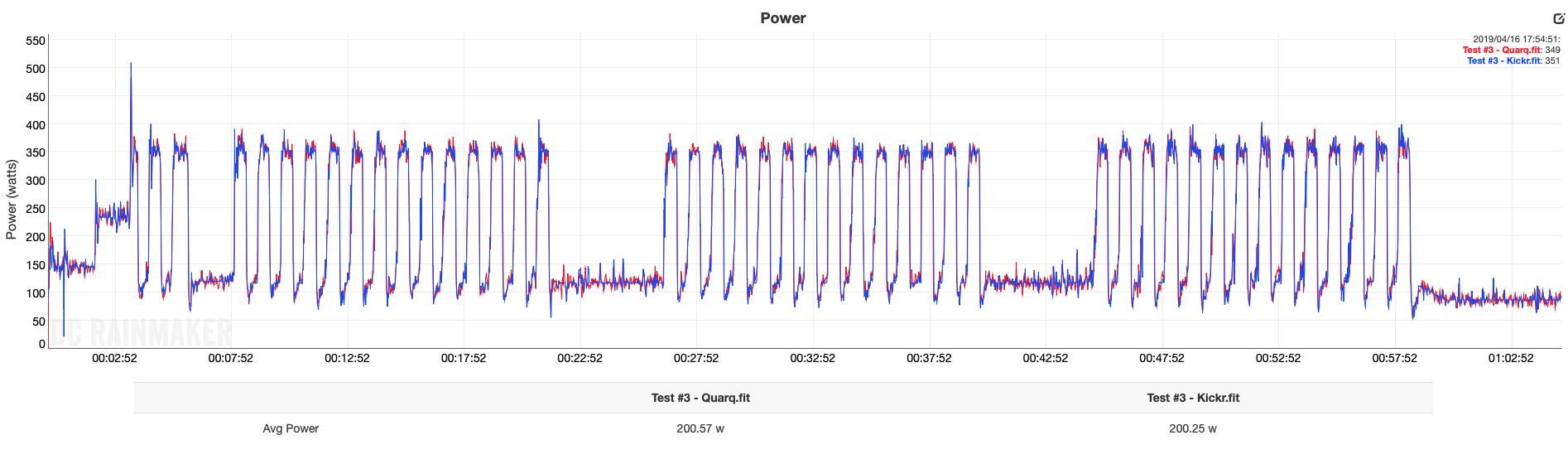

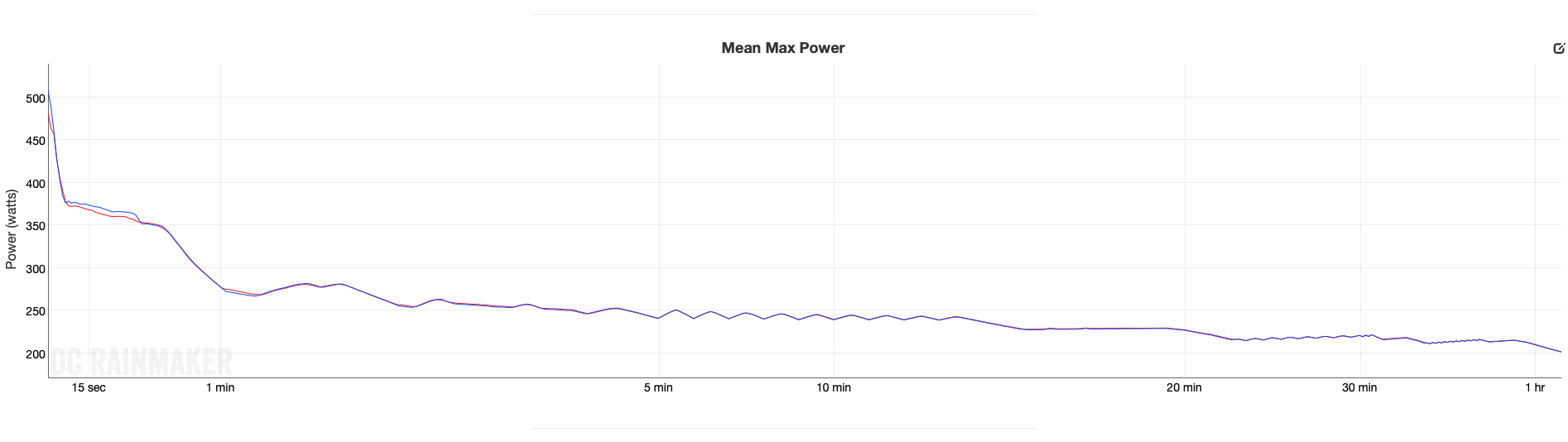

I’m wrapping up my Kickr Snap versus Quarq PM comparison. My results so far are that the Kickr is quite accurate (within 1-2%). On Taylor -2 today the Kickr and the Quarq were statistically identical:
Those graphs are so crazily close that it almost looks like the same power source, just with different sampling. My Favero and Neo are never anywhere near that close!
I’ve noticed, still doing more testing, that higher cadences track closer between the two PMs :man_shrugging:. This workout was 100+ rpms on a 32 x 18.

I agree with graytham. Looks like the same power source. Sorry, I’m not buying that a Kickr Snap can be this close to a power meter.
Ummm, ok, lol. I guess I’m a liar :lying_face:. I removed the smoothing from the DCR Analysis Tool and added the fit files. Maybe this will help with your “buy in”? :crossed_fingers:
It’s ok! some people just don’t want to believe other people have big power numbers, or that other people can properly record power data. Thanks a lot for all the info!
My comments were based upon the data you posted in the first graph. You should have posted the actual data not the Wahoo artificially smoothed as my comments would have been a bit different. Not calling anyone a liar. Having had 2 dud Kickr Snaps and coming across many other people with similar accuracy problems it’s very hard for me to believe a Kickr Snap can be so close to a power meter. You’re fricken lucky to have got one that works as it should. Make the most of it. I’m very glad to have got a refund on my replacement Snap and bought something else.
BTW your Snap is more accurate than my Hammer trainer but it’s close enough. I use power match anyway for workouts.
I don’t think that anyone thinks that you’re lying! It’s just that I would be surprised by any two power meters tracking that closely. The best Snap in the world is still going to be a little bit affected by the differences between how it does things and how e.g. a Quarq does. If I got a graph like that from any pair of my power sources, the first thing that I’d think was “I’ve somehow accidentally recorded the same source twice”. But if you’re sure that you haven’t, then great - you’ve got an awesome Snap!
I didn’t post/use any smoothing from Wahoo. The DCR analysis tool allows you to apply smoothing to compare power files. To discover abnormalities when comparing these files it is recommended to use some smoothing (ie: 10 secs) so differences don’t get lost in the numerous data points. If you remove smoothing it’s difficult for comparison. The point is to ensure both PM track consistently, not that every 1 second sample is precisely the same, since the PMs may sample and report at different moments.

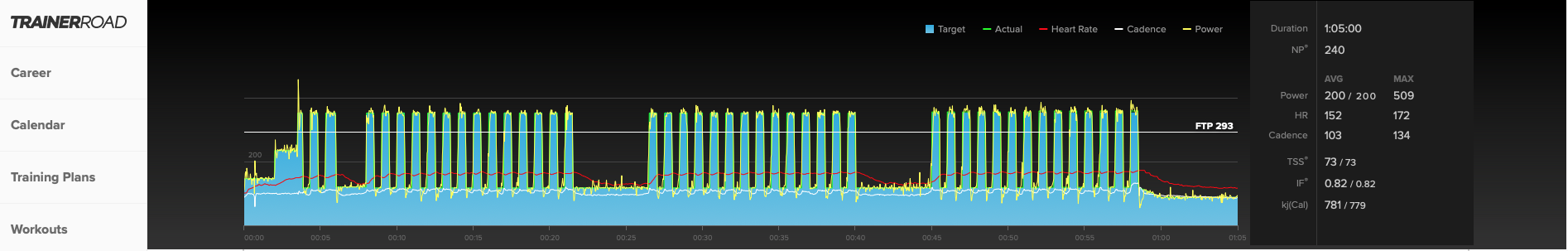

It’s near impossible to “accidentally” recorded the same power. TR is using the Kickr’s Erg and the Quarq is reporting to the Wahoo Bolt. The Kickr and TR doesn’t know the Quarq or the Bolt exists. The Quarq doesn’t know the Kickr or TR exists. Then you simply download each .fit file from the Kickr and the Quarq and load it into the DCR analysis tool.
I was careful to phrase my point correctly (“the first thing that I’d think”). Please don’t be defensive (maybe you’re not, can be tricky to tell in text). It’s only near impossible to accidentally record the same power if you know how you’re doing that, and you hadn’t said (unless I missed it) how you were recording that previously. I have done similar things all kinds of ways, including using TR (connected to a particular trainer or source, but with past knowledge (i.e. pairing info) for others, certainly), and also multiple head units connected to multiple power meters, where those head units each know about multiple power broadcasters including the trainer itself. I do take care to disable the ones that I don’t want to record, and do pay attention to the data files (which record IDs of the sources), so it is indeed absolutely possible to be sure of what you’re looking at, but it’s also (based on the information you had given us) nowhere near impossible for someone to accidentally record the same power in some circumstances.
