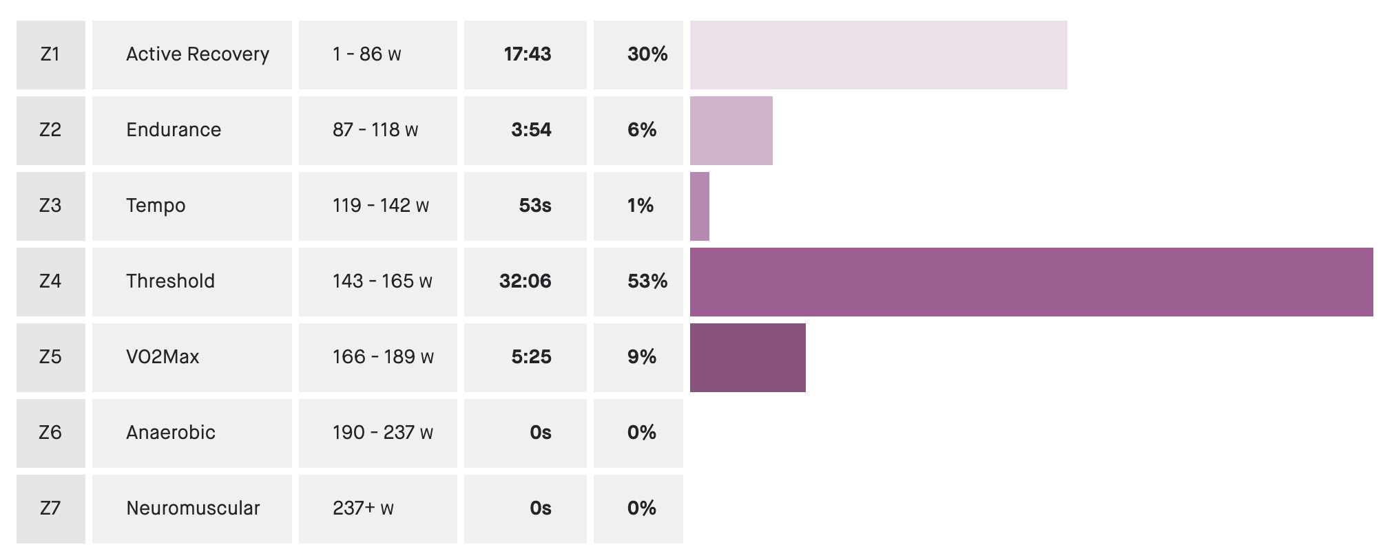

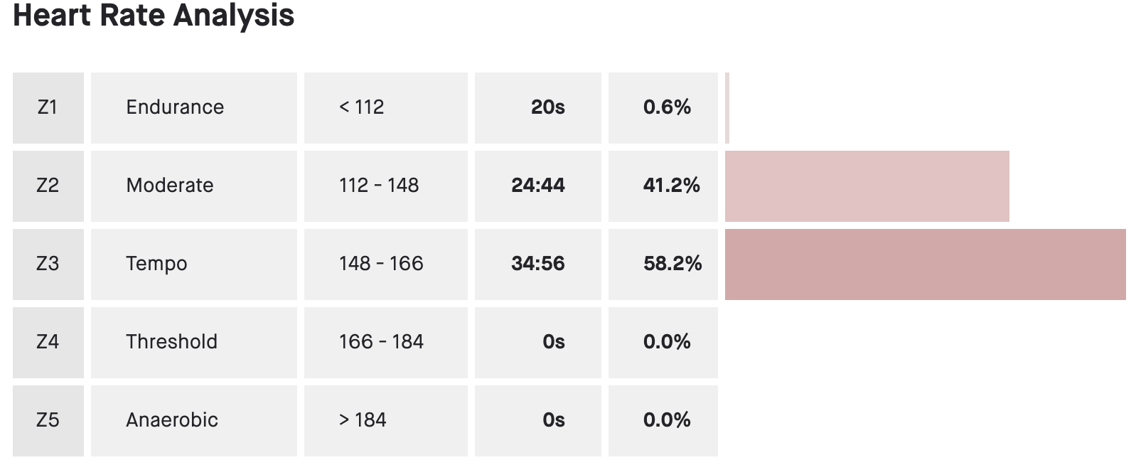

These things are personal, but that doesn’t sound like sweet spot to me. For instance, I looked at my last Carillon and at the high points HR-wise I was generally 15 beats lower than my estimated LTHR (so for reference around/under 160), and I found it fairly comfortable.
