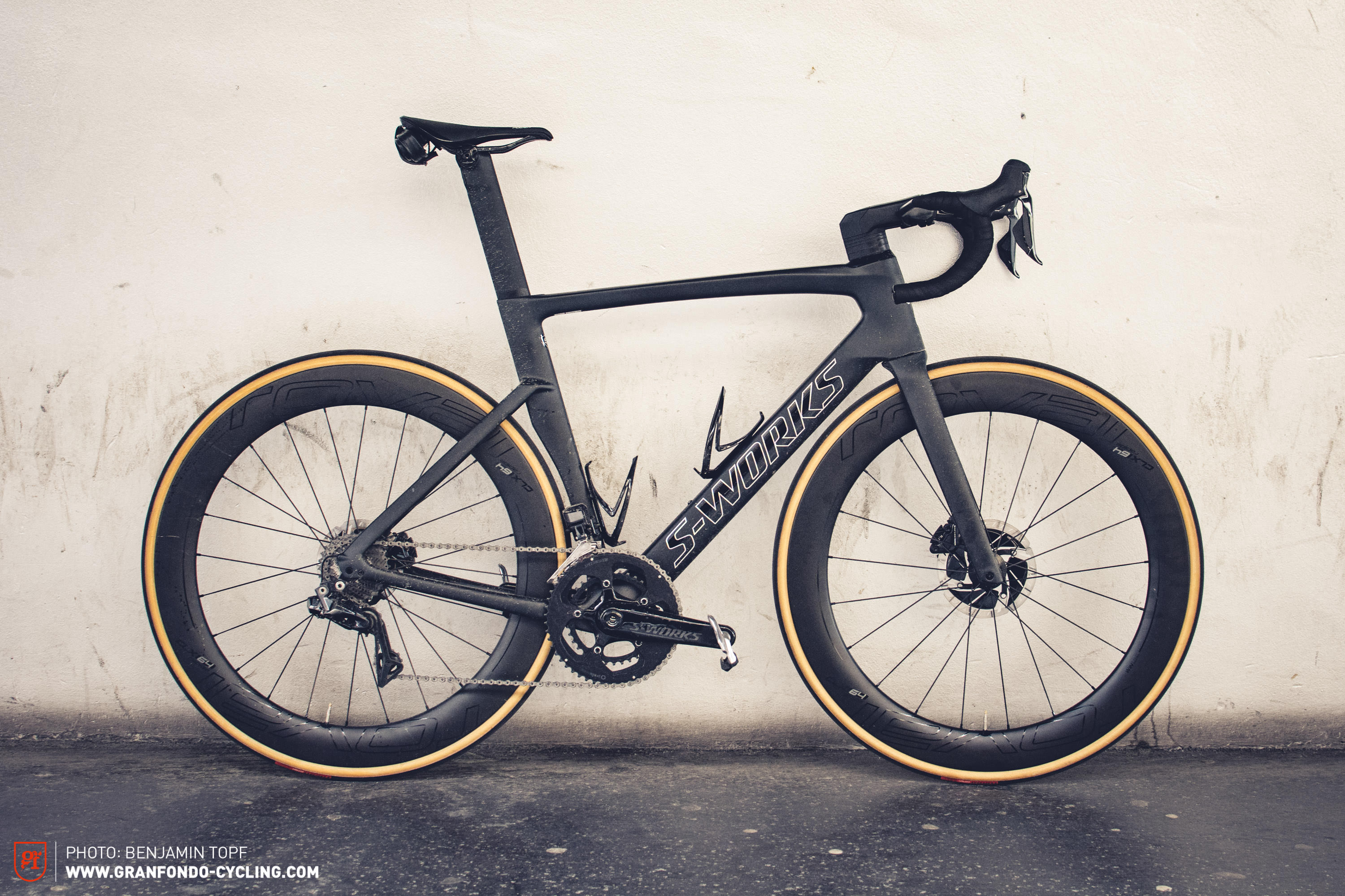

A pro would probably be looking at a 52 or 54. Look at Sagan, slammed but arms not very stretched out in front. Pros often trade reach for drop.
TOC_Sagan
If anything, aero bikes usually look fine with spacers since they are usually shaped and integrated. I wouldn’t worry about it.
