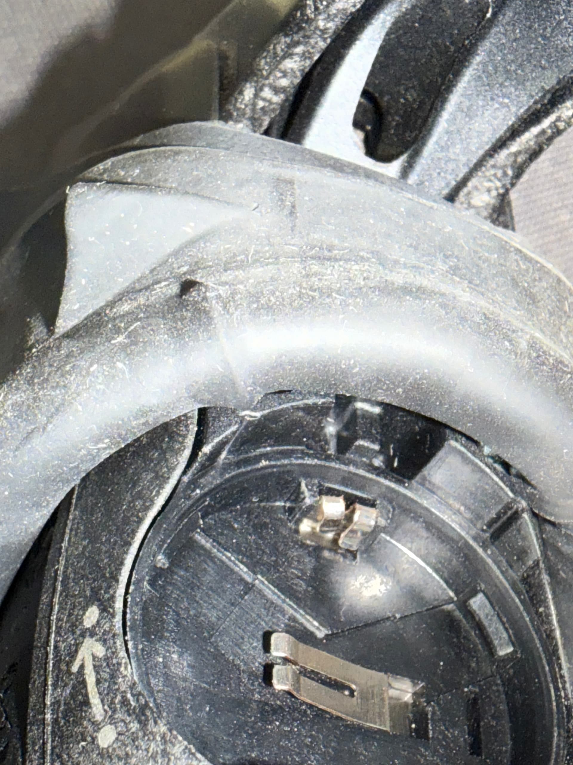

Had the same battery drain issue on my left Red AXS shifter – turned out one of the little contact tabs under the battery was bent. Straightened it and it fixed the problem.
