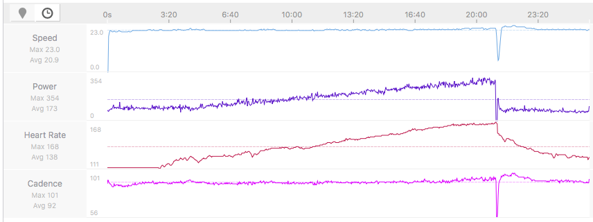

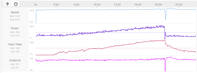

Another example from my last workout (Gibbs aerobic endurance):
Erg%20Speed%20Sim%20and%20Gibbs
Speeds are clearly rpm based, where 92rpm at -11W results in faster speed than 91rpm at 172W. Based on that, the cadence increment is 0.2mph/rpm. That is confirmed when looking at the two 172W efforts, that differ 0.6mph (= 3 rpm * 0.2mph/rpm).
Flat line speed reported in ramp test on Sept 24:

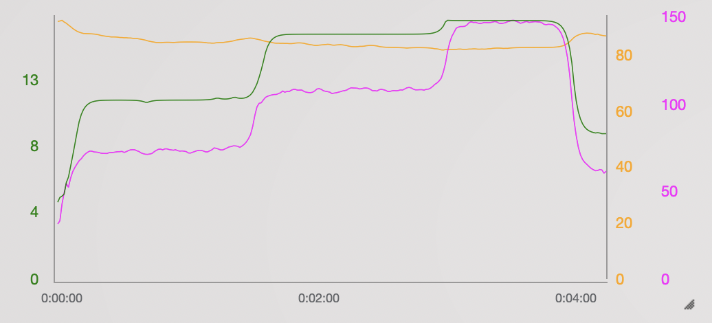

Yeah, that’s frustrating. Here are the captures from Training Peak with a Test yesterday (no calibration) and this morning (with calibration).
No calibration - Yesterday
Speed (green) follows Cadence (yellow).
Calibration - Today
Definitely more in line with Power (pink).

Yup, your second ride chart looks good.

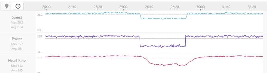

I have a Kickr Core on the latest firmware, it seems to work fine for me (although to be fair I haven’t ever really cared about speed on the trainer)
Thanks for sharing your experience! Yeah, yours looks to be correct. Are you running a cadence sensor or just the KICKR Core? And I’m with you on the don’t really care about the speed… For me it’s more of an OCD, I paid this money so it should work right issue. But who know’s maybe we stumble across a workaround, or the developers take note and fix it.

I get cadence from my power meter, so I have a Kickr Core running Power Match with my P1 pedals which provide power and cadence information
Speed looked to be okay on my Ramp Test this morning.
