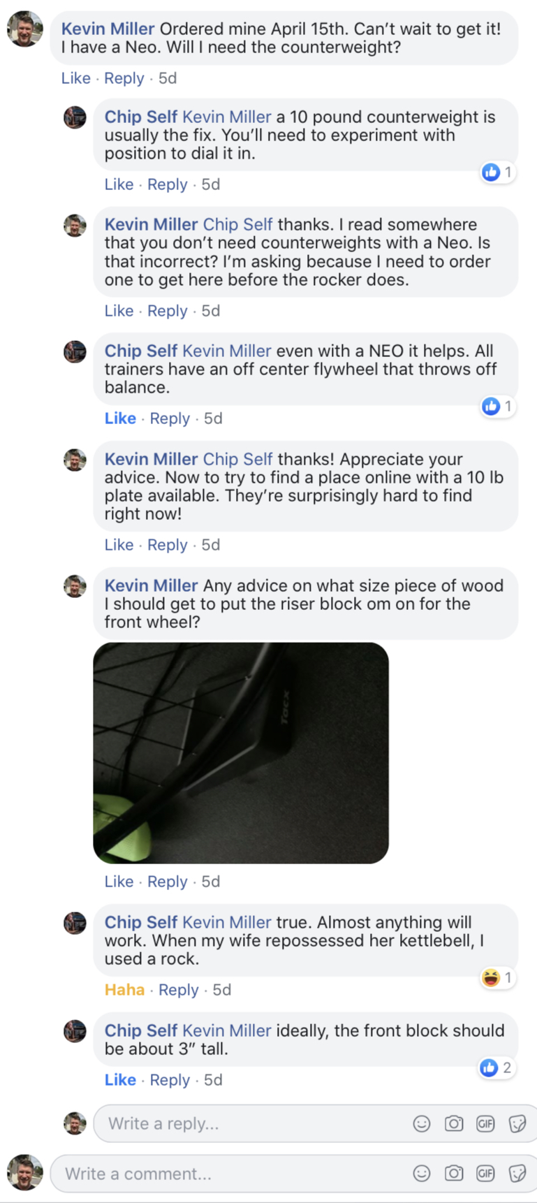

So finally got word that mine has shipped. Since I’ve never used on before, does anyone know if a standard trainer wheel block thing to raise your from wheel work with this… with the sway and with the increased height
Along with the comment about a 3" riser, make sure that any riser you have and use is not too restrictive around the tire. It must allow at least 7* lean without binding the front wheel. When in doubt, I recommend a simple, flat support. I’ve always hated the cradle type risers.
Now I just need to find a 10lb rock ![]()
