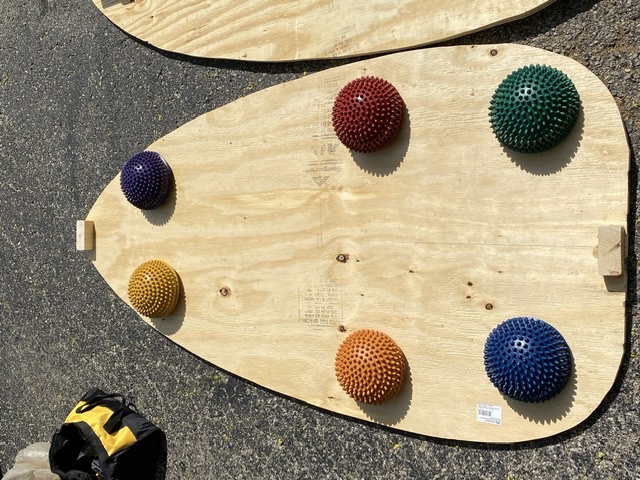

Basic rocker plates can be super-cheap to make…I think mine cost less than $60 in materials and a few hours of labor.
Nothing super fancy, but just enough left / right rock to add some comfort.

Not really…I can’t remember where I got the design for the top and bottom plate, but it was two pieces of 3/4 plywood, a 2x4 down the middle (with rounded edges) and mini-bosu balls for suspension.

I feel like I could make that. The website doesn’t show what’s underneath? As in what makes it give?
It has 3 simple curved ribs, and can add balance pods for more resistance. Similar to this design.
I fail to see your point. :crazy_face:
That looks to be about 1-1.5” off the ground? Is that enough? Also are the balance pods? Inflatable balls? If so do you have any recommendations? Or would you forego the curved ribs and just go for the balls?
Thanks.
I’m not at home or I would take a pic, but I think they’re this
