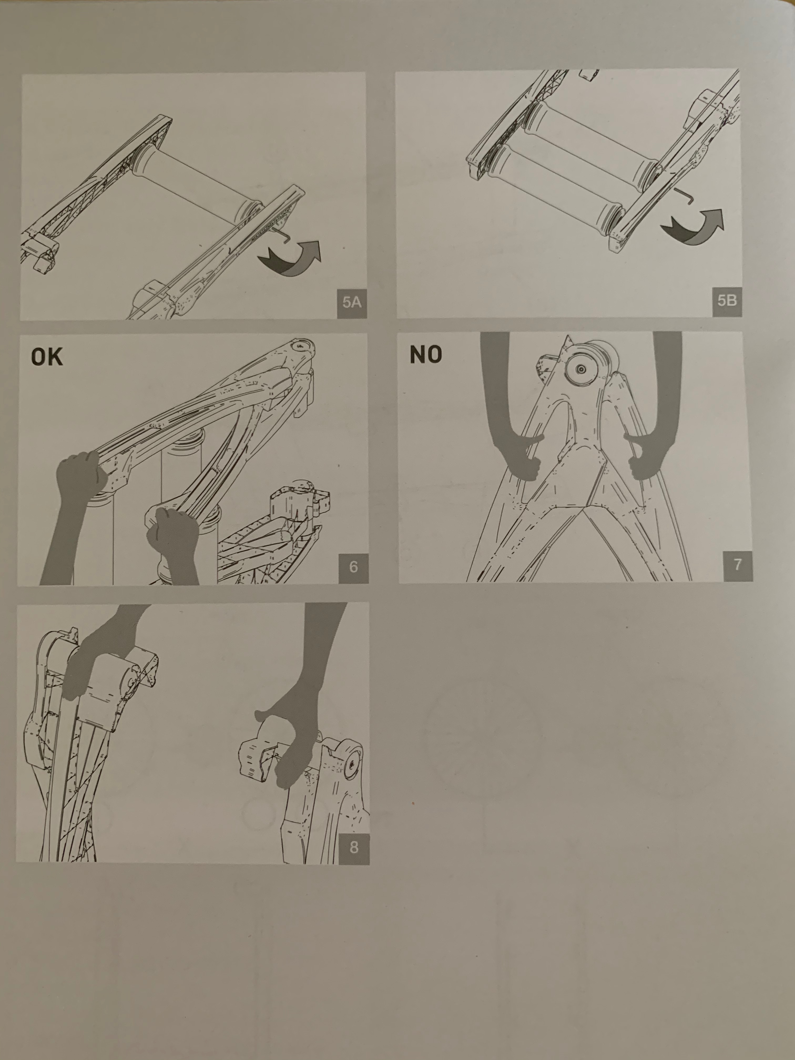

I have those same Arion rollers (I think that’s what you have there) and can get you some pics of the manual as they were only delivered last weekend.
But as others have suggested I think your roller needs pulling in. From memory you measure the distance between your two axles and match that up to the closest measurement on the stickers on top of the rollers, if they’re still readable.
That’s my current position, moved it back a bit.
But the manual would be awesome, thanks.

Here you are @ljuvlig-bawdy, sorry got sidetracked yesterday.
Cheers dude
