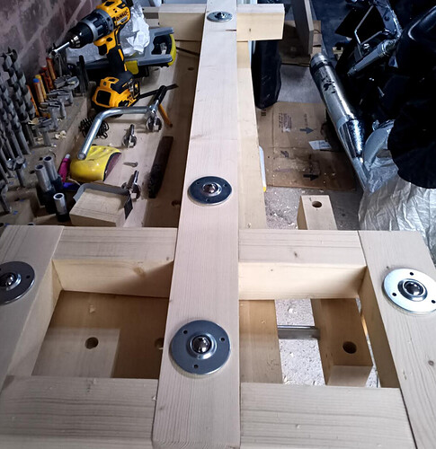

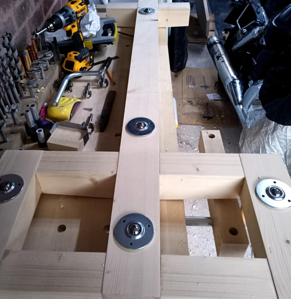

Well it’s taken two years and was mentioned to @mcneese.chad that long ago that I had some plans for a rocker plate. The original experiment was some bed slats glued together, that has been working for an age and with a few weeks off over Christmas I finally got my wood and parts ordered and took the design in a slightly different direction from those seen in this thread.
I wanted the sideways rocking, something I’m use too with the curved bed slats, but also wanted full horizontal movement, independent 360 degrees both at the rear and the front of the rocker plate. I expect to have it finished by next week and will publish my full build for anyone interested. Also to keep costs down I’ve mainly used softwood, though many blocks of hardwood have been used where strength is required. Have also harden up the underside with some steel plating for the castors to run on. No really idea what its going to feel like, but any movement will be better than none!

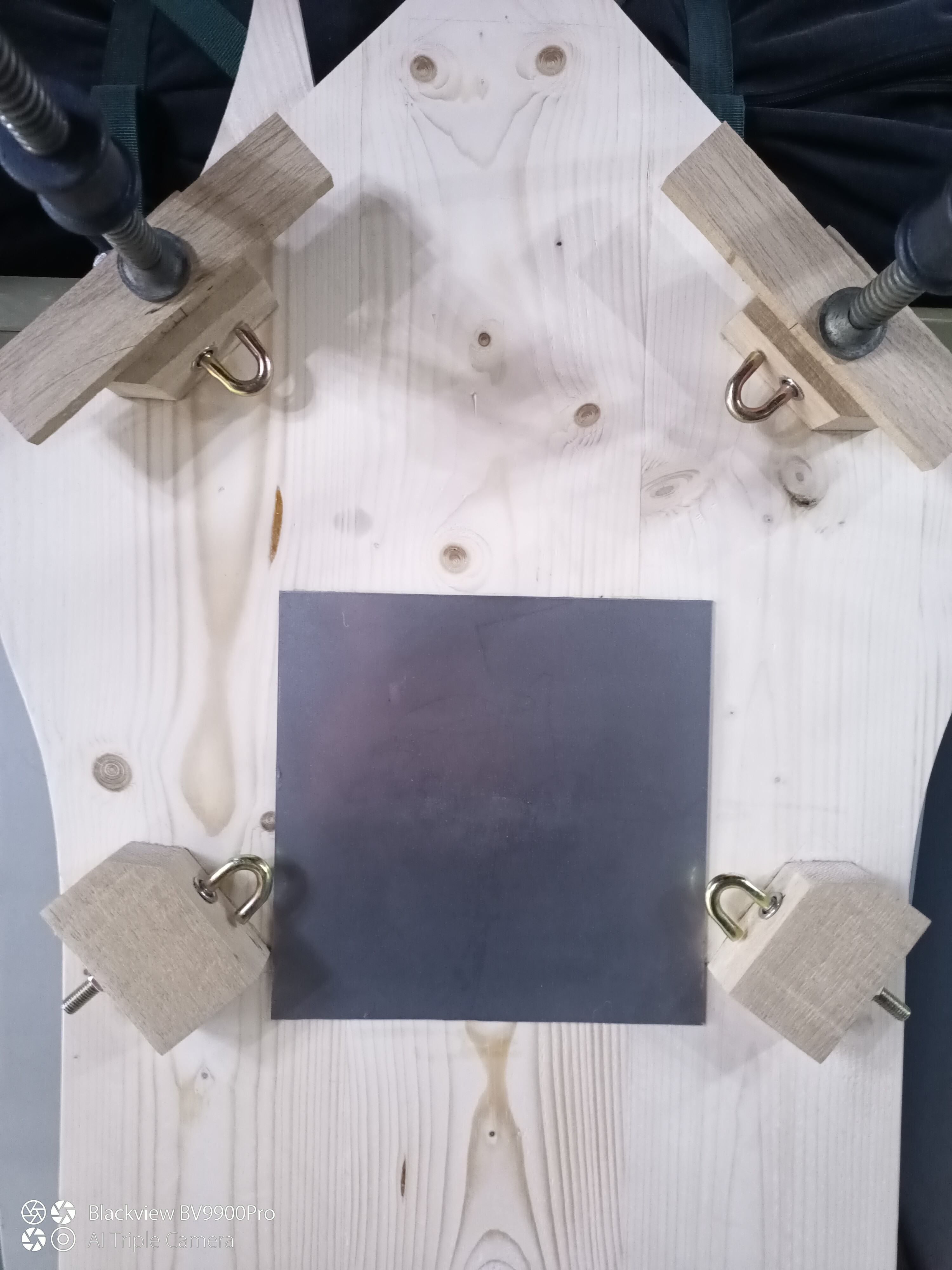

Steel plates fitted to the underside of board, board created using planks biscuit joined.
One of the adjustable mounts for the board
Castors (rated at 60kg per castor) fitted to main rocker frame

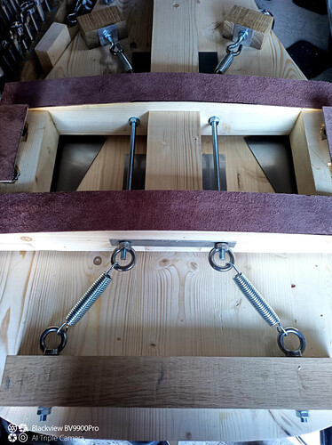

Springs fitted to rear, adjustable ones on the front
Curved underside have a leather topping. There are also two spring mounted side bars for some resistance of the rocking.

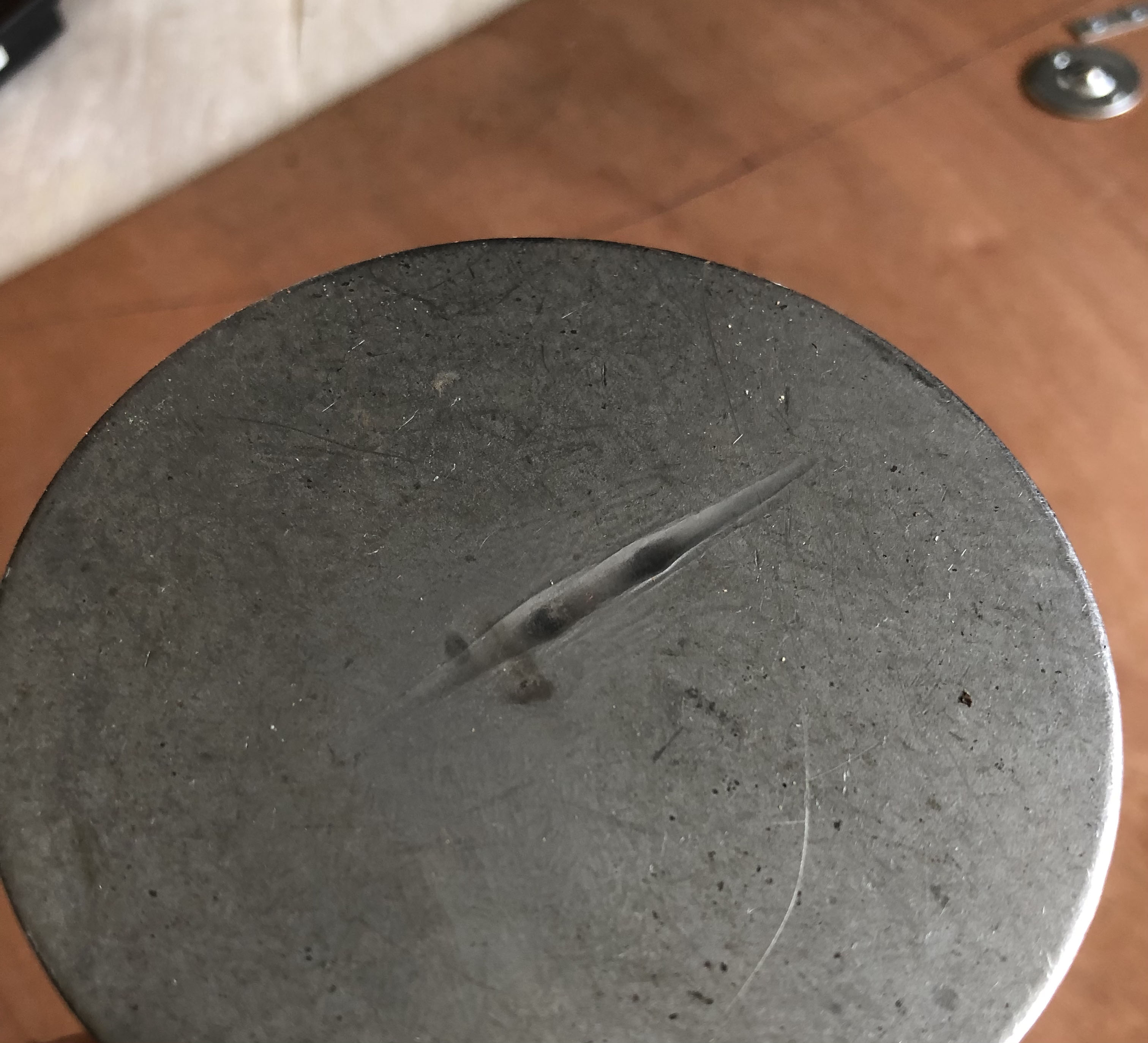

Those ball transfer units are great for light loads but not so good with a heavy load on top. The attached photo shows the wear from the point load of the Carbon steel balls on mild steel after a few 100km. I used 14 of them on an early prototype model. Same wear occurred at a slower rate on harder stainless steel. I also tried nylon units but the motion was much more restricted.
If you are going to epoxy the base of your deck then make sure you can still remove the steel plates as they will need replacing.

IMG_1268

What rating was the load per castor ball you used? The ones I’m using are rated for 60kgs per ball, maybe my five will have to be increased to distribute the weight and hopefully I’ll get more than a few hundred kilometers out of the ball/plates. Maybe I’ll have to use different material for the plates. Not too worried about replacing plates, can always overlay, maybe I should go down the marble route! Will have to consult Mohs scale of materials!

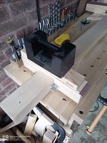

Have just finished front spring attachments and leather for front rocker… Will assemble later, make sure all fits before lower epoxy prep/pour.
Case of waiting for various glues to dry now…
