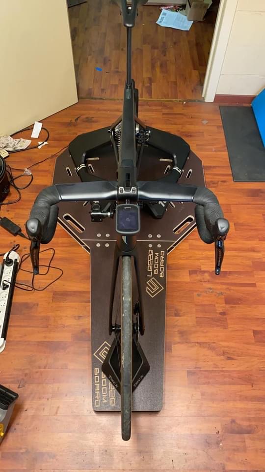

just ordered a LEEZE BOOM BOARD , excited to get it set-up :wink:

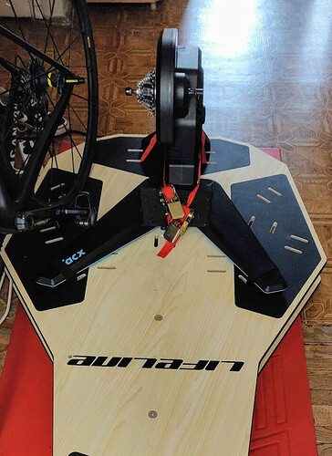

For me, it’s not a problem at all (to leveling it). I used language strips and now it’s just perfect :slight_smile:
I forgot, I didn’t put the balls into the wholes. I moved them a little bit outside and I pumped them using floor pump. Thanks to that operation I could just setup the trainer in the best possible position on the plate.

Cool, you are one of the first I’ve seen grab a Boom Board. :smiley:
I will let you know how I get on . Not easy to get the springs installed on your own :grinning:
First ride on the boom board rocker and I really liked it , no experience with other rockers but this feels really good . No low back pain which is a big plus . Now see how it goes when I do some sweet spot and treshold :grinning:
Oh an out of the saddle this is really much better than a fixed trainer !!!
Right on! :smiley:
