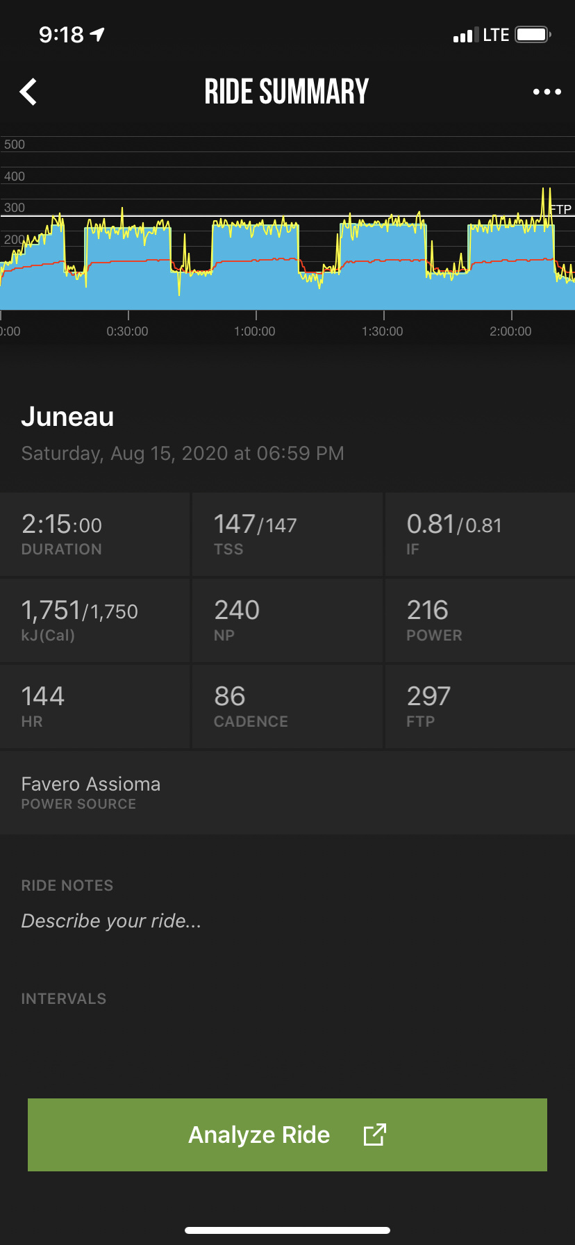

I did Juneau this evening and while I took a 2% reduction on the 3rd interval, which was more mental than anything, HR and RPE were down and I wasn’t seriously wondering if I’d be able to finish. I did have to spend the last 5 minutes of every interval telling myself that Ive put in the work, i had the fitness, this is where i belonged and I can suffer as well as anyone else.
