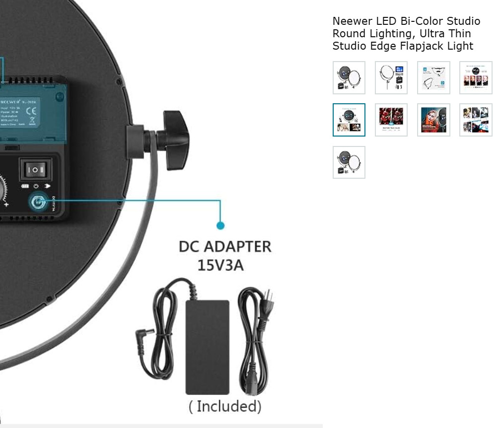

We lost our Kickr power brick/cord when we moved back into the RV full-time.
I plugged in a 15V 3A cord that fit from a ‘Neewer’ branded studio light.
It’s working, but it feels like we have to ride at 20-30% more watts than our computer is telling us we’re actually riding. Can anyone explain this? Wife still has 3 hours to go on a trainer ride.
As in, trainer at 150-160W in erg mode feels like 200W (or maybe more).
Here’s the cord we’re using:
from:

Back when I had a Kickr Bike, I found that the power supply looked almost exactly like the one from a wifi router I had. I remember that because I myself was wondering what would happen if the Kickr brick bricked and I had to wait for a replacement. There are other bricks out there that should work fine. (Just don’t over do the voltage/amperage, they are known to be sensitive to that)
