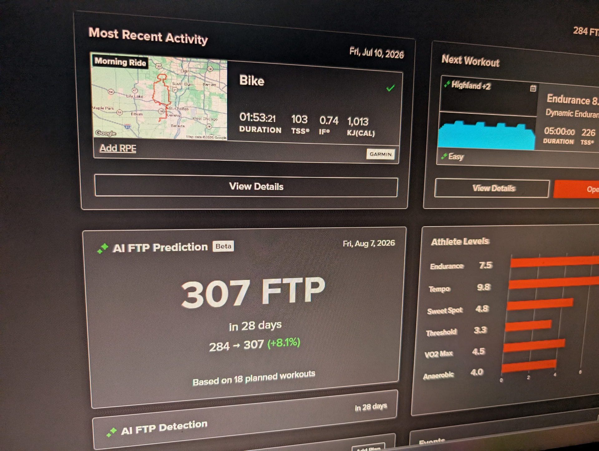

Yeah TR user and legit disciple for 14 years, but AI prediction and detection brought me from loving it to being irritated by it. Predicting 8% gain in 4 weeks for a highly trained athlete? :face_with_raised_eyebrow: c’mon. If course it did tell me this the same way for the past three months. Losing confidence in the product. I really WANT to love it. PLEASE roll it back or fix it!
Is this issue effecting many users? If so, I agree that it should be rolled back. It’s eroding user trust.
As of now, it seems to be affecting a relatively small minority. That said, it’s our number one priority right now. We have been building and testing different solutions for longer than we’d like (a complex issue to solve as most solutions could introduce novel bugs for a majority of athletes), but we’re making progress!
