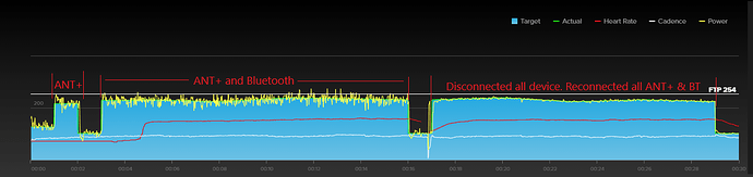

Tested a couple things tonight (results below). Concluded that in my case the difference is marginal and doesn’t impact the overall quality of my sessions. Both intervals felt similar in terms of intensity. Much the same conclusion as the TR thread the explains powermatch…
Session completed on my Macbook.
Block 1 - ANT+ only. Favero UNO and Bkool pro 2. Powermatch (new)
Block 2 - Put bluetooth on. Seemed much the same as ANT+ only
Block 3 - Disconnected and reconnected all ANT+ and bluetooth devices and it looks like it defaulted to the bkool with no power match but power match was on.
Not entirely sure why the second interval resorted to the bkool only even when both devices were connected.
I did try bluetooth only but that didn’t work as i hadn’t enabled the double power function in the UNO settings. Will give that a bash.
