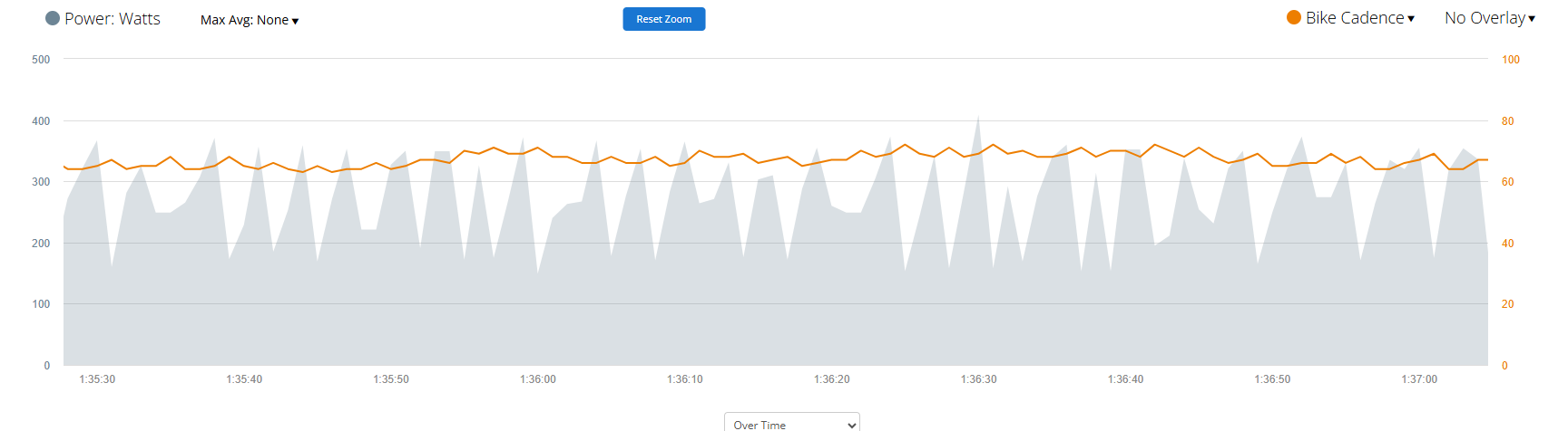

Does anyone here use the Wahoo app in erg mode connected via Bluetooth with a power meter connected via ANT+ and the toggle “on” so that the power meter controls the trainer?
In the past I have had pretty good success with this setup being accurate and consistent; but lately I’ve been seeing some pretty big variations.
Below is an image from today, zoomed in on a 10 min interval. For this interval Erg was set to 290W, but the power seems to be all over the place. I know some variation is expected but is this amount normal? The avg for the interval ended at 279W despite the target of 290W in Erg. Using a Sram crank-based power meter and a wahoo kickr V5 FWIW.
Anyone experienced anything similar?
