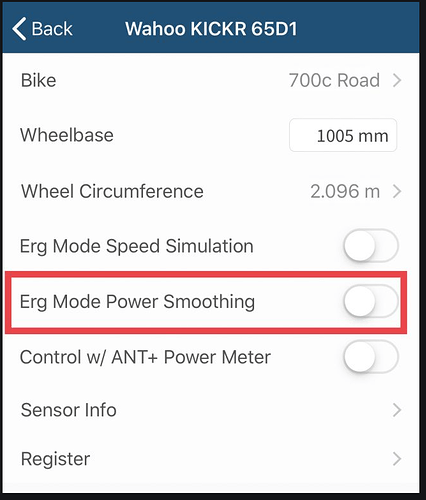

I suggest Wahoo “Erg Mode Power Smoothing” set to OFF:

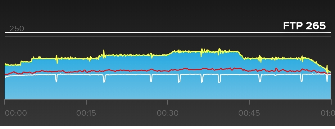

Below my build in power meter raw data-graph
The TR graph still looks like ERG smoothing on the Wahoo app is turned ON. Also looking at the variation in your cadence e and the lack of correlation to Power graphics, is another indication that ERG smoothing is probably ON.
Here is my recent ride on a Kickr with no ERG smoothing.
I switched ERG-Mode Smoothing off in the app :man_shrugging:t3:
Will check this next time again :nerd_face:
