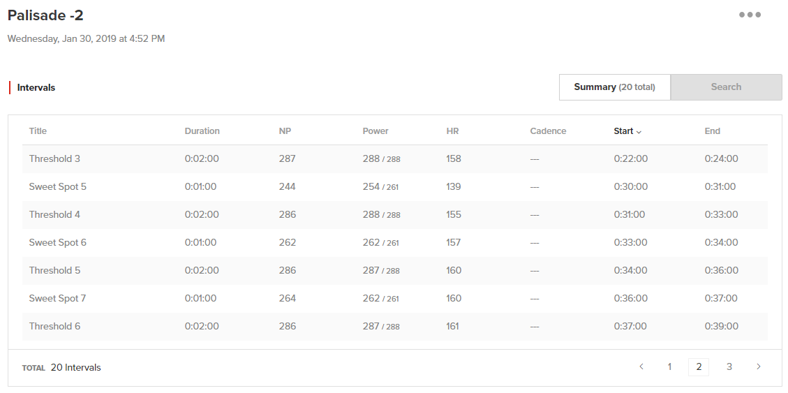

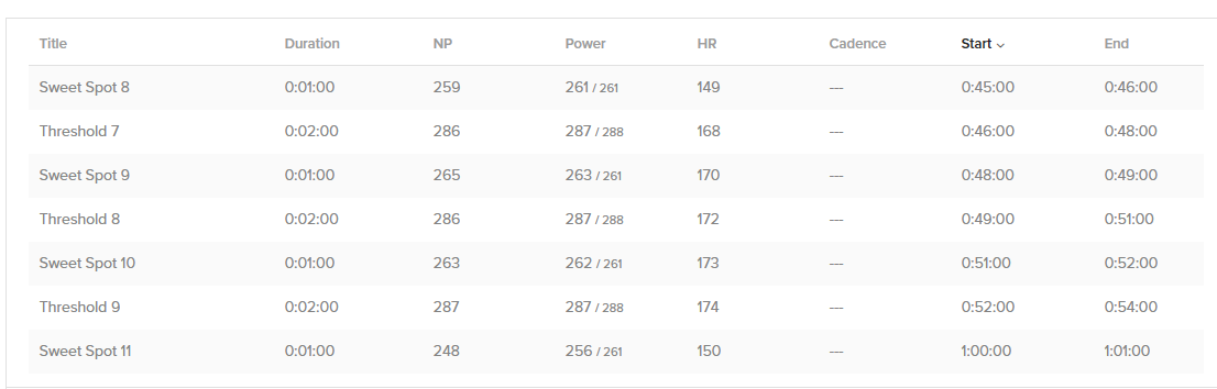

What should HR do on these? My HR is not going down on the “unders”, is my FTP set too high? Am I on target?
This is from Palisade (after a 2-hour wife-ride this morning)
I should probably note that I had a minor medical procedure yesterday so let’s look at this one from the day prior (though a shorter workout):

HR is probably not going to come down more than a beat or two during the “unders”. I checked all my previous O/U workouts and I can’t find one where my HR dropped substantially during an “under”. This is particularly true in the workouts where the “over” is longer than the “under”, as is the case with Palisade.
