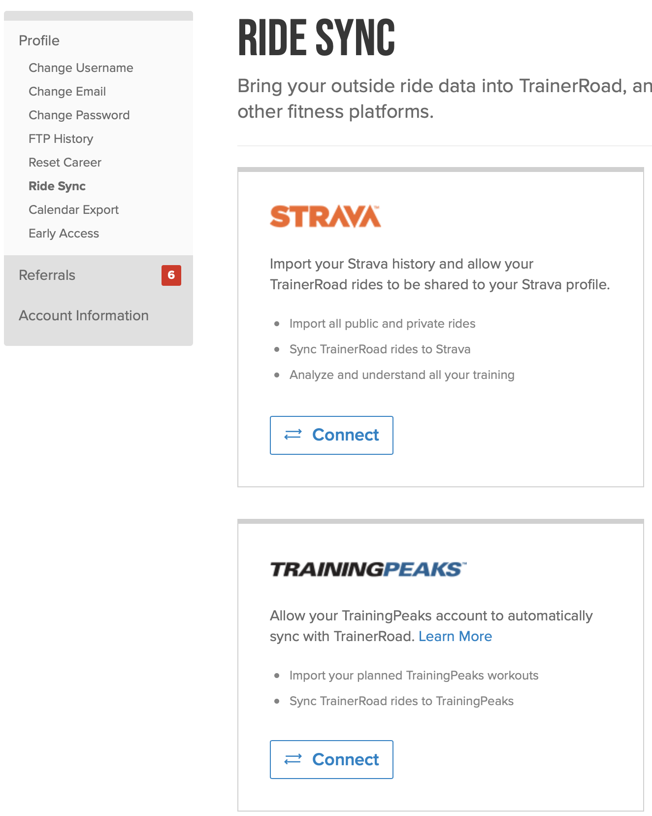

For those of you that are training with other coach’s plans, assuming your workouts are all on TrainingPeaks, how are you doing indoor rides? What’s controlling your smart trainer?
Right now I’m following FasCat’s At Home Strength Training Plan and it includes bike workouts. I’d like to follow them as opposed to finding a close equivalent on TR. Everything is pushed to my Garmin, thinking maybe I can control my KICKR via Garmin Connect or as a last resort I’ll just build all the workouts with TR workout creator, but I’d rather not do that.
Turn on Ride Sync for TrainingPeaks:
I’ve used it, works great!

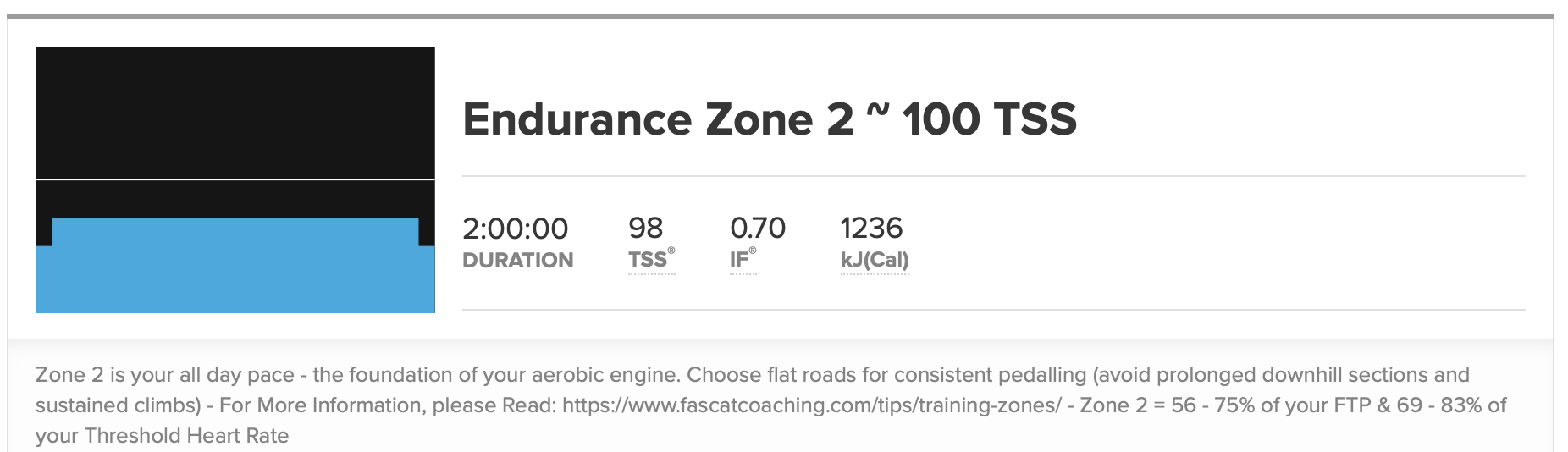

For example here is one:
after syncing they are available in Workouts Log In to TrainerRoad
