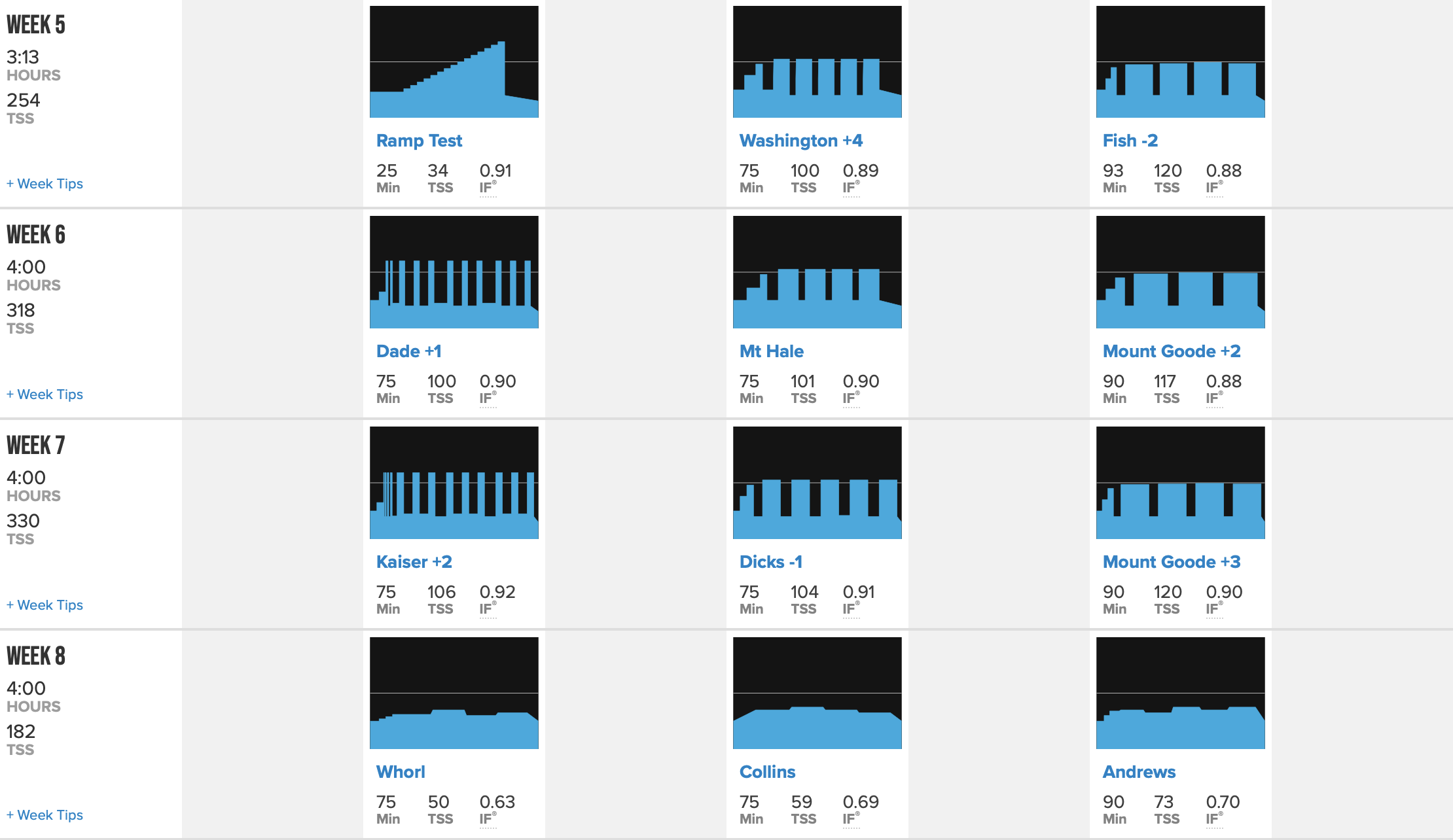

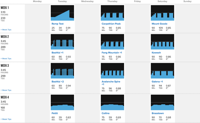

I’ll give you a TR example from Sustained Power Build Part1 and Part2 with screenshots from before AT:
Part 1:
Part 2:
Notice the increasing difficulty/TSS from part1 to part2. And IF often increases as well, but not always. However there is a clear progression in training load (total work) over 8 week build across these Sustained Power zones:
  • Tuesday is zone5, and difficulty/TSS increases from Part 1 to Part 2
  • Thursday is upper zone4/threshold, and difficulty increases from Part 1 to Part 2
  • Saturday is lower zone4/threshold, and difficulty increases from Part 1 to Part 2
Pre-AT you can see that mid-block FTP changes had no impact on increasing progression across the 2 build blocks. And the same while using the CTS/FasCat/Velocious plans. If you have an unexpected bump in fitness, you keep doing the work as planned.
Post-AT there are new TR talking points that could be interpreted as TR diplomatically saying, pre-AT, TR plans were doing it wrong (whatever ‘it’ is). Because now I read that FTP increases will result in lower difficulty workouts in order to provide a “smoother progression” and “workouts aren’t suddenly more difficult.” And post-AT many plans reduced intensity, before the plans were indexed to your PLs. And I think that is a good thing!
The difference between TR and CTS/FasCat/Velocious/lots-of-other-coaches is that TR has less endurance and more intervals. And post-AT, TR has moved a little bit towards the rest of the structured training world.
